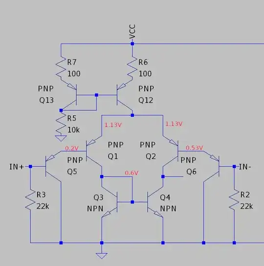

I've built the following circuit on a breadboard (for the purpose of experimentation) and measured the voltages: enter image description here
IN+ and IN- are connected to ground, VCC is 10V.
As you can see it's a differential pair (using 2N3904 and 2N3906) loaded with a current mirror for differential to single-ended conversion. The input uses Q5 and Q6 to raise Q1 and Q2 base voltages so that they're turned on even when the IN+ and IN- are grounded. LTSpice simulation seems to confirm the circuit works, but on a breadboard Q5 is saturated.
I tried the following things to try to fix the circuit:
  1. Diode-connecting the other side of the mirror instead, but then Q6 would become saturated.
  2. Replacing Q3 and Q4 with same value resistors - this seemed to help with biasing, but that I think cuts the gain in half.
  3. Replacing Q3 and Q4 with some other transistor (2N2222) - this didn't make a difference.
I was hoping that it would work, even considering the obvious parameter mismatch between discrete transistors. Any ideas what am I missing?

    Your measurements suggest Vbe of Q1 is 0.9V. That should tell you something is wrong either with your measurements, or with Q1. –  Aug 07 '21 at 14:39
  • The inputs are labelled the wrong way around. –  Aug 07 '21 at 15:03
  • I find 0.524 V in place of 0.2 V – Antonio51 Aug 07 '21 at 15:11
  • DC gain is about 33db. Phase strange. Follower ~ok. Will try square waves. – Antonio51 Aug 07 '21 at 15:23
  • Square wave input 5 kHz 2mV pp (around 0V) ... Output 761 mV to 866 mV, gain 47, trise=4 us, no overshoot. – Antonio51 Aug 07 '21 at 15:42
  • Matching between the transistors is essential. I'm particularly suspicious of the matching between Q3 and Q4, but every pair of transistors in this circuit, other than Q12 and Q13, must be matched for proper operation. That is, Q1 and Q2 must be matched, Q3 and Q4 must be matched, and Q5 and Q6 must be matched. Remember that temperature differences also cause mismatch even if the transistors measure identically at room temperature. – Hearth Aug 07 '21 at 16:25
  • @Antonio51 I rebuilt this circuit again, double-checked everything, and still have 0.2V at Q5 emitter. Have you used the same transistors? – npnman Aug 07 '21 at 17:23
  • @Hearth, I know, but still I'd expect some relatively valid operation, what happens though is very surprising. I've replaced the Q3 and Q4 with matched transistors from MC3346P, but that didn't make any difference. – npnman Aug 07 '21 at 17:26
  • @user_1818839, absolutely agree, but I've checked the measurement many times, and I am surprised as well to read 0.9V across emitter-base of Q1. I've also replaced the transistors and checked they work as they should (and that I haven't accidentally connected emitter where collector should be, and vice versa) with a transistor tester. – npnman Aug 07 '21 at 17:29
  • Actually measure Vbe in place, i.e. across b and e. You have some fairly small base currents in there and I wouldn't be surprised if a 10 Mohm load (your meter) was upsetting measurements if all these measurements were from 0V. –  Aug 07 '21 at 17:40
  • @user_1818839, hmm, I switched to different meter and right now the voltages seems to be about the same as simulator predicted. You were right the measurement was wrong! Thanks! – npnman Aug 07 '21 at 17:54
  • With each meter, check the voltage range resistance of the other. Some cheap DMMs are only 1M not 10M; I bet the first meter was one such. –  Aug 07 '21 at 17:56
  • @npnman - I used 2N3905 (beta 130) and 2N2222 (beta 200) transistors as you. But only in simulator microcap 12 as usual. Do you need my simulation ? – Antonio51 Aug 08 '21 at 07:17
  • @Antonio51, thanks. No need for the simulation, as the problem was tracked down to a bad measurement, but thanks a lot for offering help, you're awesome! :-) – npnman Aug 08 '21 at 09:07
  • If usefull, I have also tested replacing Q5-Q6 by BF245. Higher input impedance (10 Meg) but offset 600mV. Same open loop gain, 138 kHz bandwith. – Antonio51 Aug 08 '21 at 09:24
As @user_1818839 pointed out in the comment, there was an error in measurement that I've made. The 0.9V across emitter-base of Q1 is simply out of this world, and should have made me think twice before posting - lesson learned :-)
