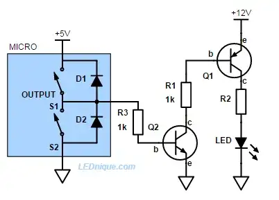

You haven't shown how you are driving the PNP transistors. Watch out for high-side driver fail.
Figure 1. The protection diodes on most logic chips creates a sneak-path to positive supply. This will keep the PNP transistor permanently turned on and may damage the chip.
Figure 2. To drive a high-side transistor from a GPIO pin we need a level translator. An NPN transistor does the job nicely.
Images from my post on High side driver fail which has some more text on the issue.

  • We're using a 9V power adaptor as our voltage source. Also right now I have it as Fig#1 and the PNP I'm using is this one https://www.onsemi.com/pdf/datasheet/mmbt4403-d.pdf and PIC18f4220-i/pt. 5V and High-Current Sink/Source 25 mA/25 mA. – Citi Jul 31 '21 at 21:21
  • I think I need to implement figure 2 since Vss > Vmicro. I have the PNP like figure 1 with 10k at its base. I would just need to make the Port pins go high to drive the NPN – Citi Jul 31 '21 at 21:22

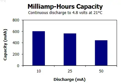

One more thing. The battery voltage of \$9\:\text{V}\$. Let's look at a typical ENERGIZER 522 -- 9 V batttery:
Right off the bat you can see that they just barely allow about \$60\:\text{mA}\$ draw. Maybe. (They are rated in the other curves for a lot less draw.) So, sure. You can use one.
But what about the voltage? Note that the above chart specifies \$4.8\:\text{V}\$? Do you expect to use one down to that voltage??? I doubt it.
Now think a moment. You already know that it is possible that you might have a (3) LED in-series string requiring as much as \$7.2\:\text{V}\$. Sure, you expect no more than \$6\:\text{V}\$, typically. But you don't design for "typically." (Or you shouldn't.)
You could drop down to just (2) LEDs, in-series. But I think you need to plan for some battery voltage other than \$9\:\text{V}\$ in your design.

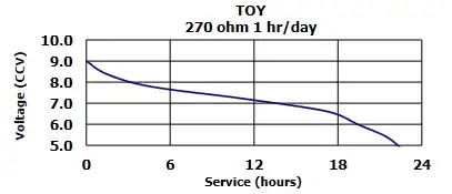

Let's look at another curve from that datasheet:
See how rapidly the voltage drops to \$8\:\text{V}\$?? And it isn't close to being used up, yet. I might pick \$7\:\text{V}\$ as my minimum design voltage. You need to pick your own number. And then stick with it.
How many LEDs, now?

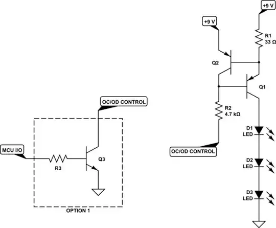

Here's the schematic I'm thinking about, right now:
schematic
I'm assuming above that your MCU cannot stand-off high voltages. So I've included option 1 for driving the circuit. There may be other options to consider. (An NFET comes to mind.) But again, I'd need more details and your thoughts about NFET vs BJT.
(At these current levels I like BJTs more -- they are cheaper and easier to get and I don't have to worry about whether or not I'm grabbing one with the right \$V_{_\text{GS}}\$. But that doesn't mean I wouldn't use an NFET if a junk-box one was laying out and handy.)
Anyway, there's a thought to consider. It's an active circuit. And it will work quite well. It is stable against temperature variations, as well. (Also against variations in the power supply rail. So long as there is enough overhead and the devices can dissipate wasted heat. But it's better to avoid wasted heat and just keep the supply rail close to what's needed, if possible.)
You can probably work out \$R_3\$ given your MCU voltage and that you only need about \$150\:\mu\text{A}\$ into the base.

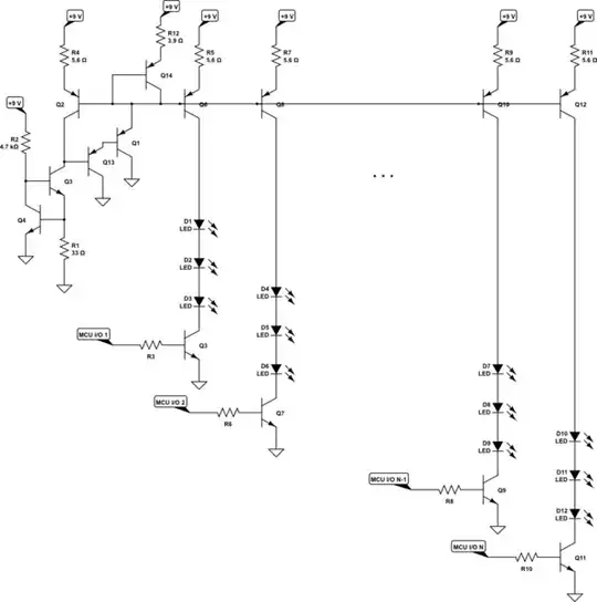

EDIT: Added for the case where you want only (2) BJTs per series chain...
If you are willing to sacrifice some BJTs for the common good, then you can use mirror BJTs, instead. This will reduce the number of BJTs per string to just two, instead of three.
The high-side resistors of \$5.6\:\Omega\$ are there mostly to limit source current with the series string isn't ON and to mitigate the impact due to BJT variability within a part number and manufacturer when the string is ON.
The I/O pin resistors can probably be \$27\:\text{k}\Omega\$, or thereabouts.
schematic
simulate this circuit
Note that I decided to set up a Darlington. I'd forgotten about what happens when a series chain isn't ON. (Or if none of them are...) So there are a few more BJTs in the above circuit. Make sure \$Q_1\$ can dissipate. A TO-220 wouldn't hurt.

  • Thank you for your help, I'm not using a Battery voltage supply but I getting my source voltage from a DC Power Adapter with Max current of 500 mA. I see how 4 LEDs at 9V will be a problem. I think the best route would be to use 3 led – Citi Jul 31 '21 at 22:37
  • @Citi That's a good decision, I think. In that case, I'll add something. – jonk Jul 31 '21 at 22:39
  • Sorry to "slap you in the face", jonk! :^) As usual, you're very thorough. – Transistor Jul 31 '21 at 22:42
  • Yes, using the equations above, I agree I'm cutting things far too thin. As of right now, my option would be to use figure 2 by @Transistor shown above to drive the Mirco GPIO pin and use 3 LEDs per string at 9V to improve things. – Citi Jul 31 '21 at 22:44
  • @Citi There it is, for now. – jonk Jul 31 '21 at 22:47
  • @Transistor Nah. It's the circuit that slaps me in the face. But I was surprised that you didn't look at the LED datasheet long enough to see this whole idea is crazy-minded nor immediately have it pop into your mind that reserving a nominal 1V is "slim to no chance." ;) – jonk Jul 31 '21 at 22:49

  • @Citi If you are willing to dedicate about 5 BJTs as "overhead" then you can get by with two BJTs per series-LED chain (mirror chained), instead of three. But it doesn't pay off until you have five chains or more. For a display using lots of LEDs, it pays off quickly. – jonk Aug 01 '21 at 01:01
  • Thank you for your response, I'm using dual LEDs red and green. I'll be using the 3 LEDs per chain, so there will be 6 chains, that are controlled by 6 pins in the Micronotller. So I was thinking of using 1 NPN and 1 PNP for each chain. – Citi Aug 01 '21 at 01:15
  • @Citi With six chains, it might be worth the extra trouble then. I'll try and keep it simple while also dealing (without much thinking behind it, to be honest) with BJT vagaries and temperature. – jonk Aug 01 '21 at 01:40
  • Thank you again, this means a lot – Citi Aug 01 '21 at 02:00
  • @Citi Added the schematic. Hopefully, that gives an idea. $Q_1$ could be a Darlington to reduce the offset, but unless you add "lots" of series chains I don't think it's needed. – jonk Aug 01 '21 at 02:01
  • Okay. Thank you. – Citi Aug 01 '21 at 02:09
  • @Citi I made a few modifications. I think the Darlington arrangement is probably better, now that I've thought more. I also added $Q_{14}$ to give the Darlington something consistent to sink (and some other minor thoughts.) – jonk Aug 01 '21 at 02:33
  • I see thank you, so much for your help – Citi Aug 01 '21 at 03:09
