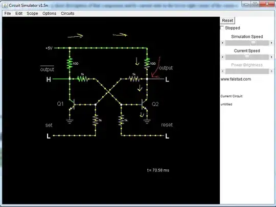

But anyways using this circuit (It's a TTL SR latch)
Simulation Link But the picture below shows the current flow in yellow. (This is the circuit linked above) enter image description here
Anyways I mostly understand the circuit, yellow is current flow. Makes SR latches make more sense......but how come current isn't flowing into "OUTPUT" where I pointed with my Red arrow. I mean the Compliment Output doesn't really have much different, I mean current is flowing right next to both......or is this because this is on conventional current? I guess I just don't understand why both outputs are not High regardless....since we have current flowing right next to them (The dot over wires on them means they are connected correct?)

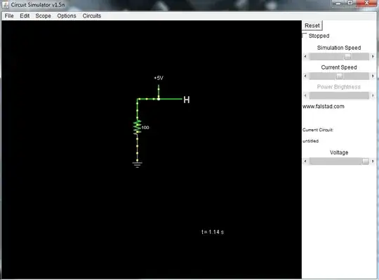

To Put simply I guess also: Why does this show High enter image description here
But this shows Low enter image description here
When they are practically the same circuit....but one output is literally just lower than the other?
    In your simulation, current can't flow to the output, because there's nothing connected to the output for current to flow into. – The Photon Feb 11 '13 at 06:50
  • I guess im confused at why Current can flow out of the Output Complement and not just the Normal Output, the difference is that Q2 has current coming from it's Base that goes into Output Complement, but Normal Output has Current flowing right next to it...so I don't see why it cannot be high either. –  Feb 11 '13 at 07:07
  • as another aside, this is an RTL SR latch (Resistor-Transistor Logic) not a TTL one, since you use resistors not transistors to pull up to 5V. TTL is a bit more complex, but usually faster and lower power. –  Feb 11 '13 at 10:59
  • @Sauron, There's no current flowing out of out-bar in your circuit either. The bright green color indicates voltage, not current. The yellow dots indicate current, and none of them are flowing out of either of the output terminals. – The Photon Feb 11 '13 at 16:58
  • @ThePhoton, makes sense....but why is there no current flowing out then? or just because it's not a complete loop..and if thats so then why is the upper Logic Out High? –  Feb 11 '13 at 17:13
  • There's no current flowing, because you haven't hooked up any wires or other devices for it to flow into. See Phil's answer, especially the first bullet point. In the water & pipes analogy, an open wire in electronics isn't like the open end of a hose, it's like a stoppered end of the hose. It allows high pressure (high voltage, by analogy) to build up. – The Photon Feb 11 '13 at 17:17
I believe the secret is in the transistors. The current on the right half is flowing straight to ground because of Q2. Q2 is active because of the small current to its base, the vertical line, from the left side.
The next question is why Q1 doesn't get activated like Q2. What prevents this is the 1K resistors. Once the current is past the 100 resistor on the left side, the only place to go is into Q2's base. On the right side, because of the 1K resistor, most will just run to ground and Q1 is never tripped.
When you press the Set switch, Q1 is switched on by applying current to its base and the reverse happens. Current on the right is now diverted to keeping Q1 open and current on the left runs straight to ground.

  • I think this makes some sense, Since the current is flowing straight to ground since Q2.....it's not going to divert. I guess I have it in my head that electrons are going everywhere....but they want to go to ground. –  Feb 11 '13 at 07:26
The answer is fairly simple:
The Falstad Electrical simulator has non-realistic components.
Basically, the "Output" components are "perfect" voltage measuring devices, that can measure the voltage at a node while drawing no current. As such, since they draw no current, there is no current flow into or out of them.
Circuit description is as follows:
  • Anyways, the way the circuit works is that when one side (lets say Q1) is turned on, it pulls the voltage at it's collector down to below 0.6V.
  • Since the collector is at such a low voltage, no current can flow though the 1K resistor connected from Q1's collector to Q2's base.
  • Since Q2's base is being held below 0.6V by Q1, no current can flow from the collector to the emitter of Q2.
  • Therefore, the voltage at Q2's collector rises until the current flow through the 1K resistor to Q1's base reaches equilibrium.
  • Finally, since we have current flowing into Q1's base, the system state stays stable.

  • @Sauron the voltage isn't the same. That's what high and low are telling you. The voltage at each end of the resistor is the same as the voltage at the end of each end of the battery, because the wires connecting the resistor to the battery are a much lower resistance path, and thus drop much less voltage (E = IR), than the resistor. – Phil Frost Feb 13 '13 at 11:12
  • Ok thats why Im confused. Overall the drop even at the end towards ground should be very small (since the wires resistance is almost neglible, and the resistor is very small). So it seems like it should still report a HIGH. –  Feb 13 '13 at 19:31

I wrote a really verbose answer that goes back to basics, and I also wrote a summarised answer, just in case my initial answer was too simplistic.
Here's the summarised version:
In your second and third circuits:
  • The resistor is using up a large chunk of the potential energy in the circuit. Before the resistor (as in, on the +5V side), the potential energy is high (and so it's a high voltage)
  • After the resistor (GND end), the potential energy is low (and so it's a low voltage)
  • It's not that the output is literally lower, it's that the one output is closer to gnd than the other, in terms of potential.
The highlighted wires in that simulator aren't really showing current flow, they're rather showing areas of high potential (highlighted) and areas of lower potential (non-highlighted)

So looking at your last two circuits,
  • There is a high point and a low point of potential (+5V and GND)
  • There is a connection between the two points (a wire), meaning that current can flow from the higher to the lower.
  • There is a resistance which is going to limit the flow of current between the high and low potential.
  • As far as I can see, the highlighted lines in the simulator are not current flow, but rather showing what parts of the wire are a high potential (highlighted) vs lop potential (non-highlighted).
  • Since the resistor is resisting the flow of current (and that's what it's designed to do), it's taking away a whole bunch (the vast majority in fact) of the energy in the circuit.
  • Before the resistor, there is a lot of potential energy (and so that part of the circuit is "high")
  • After the resistor, there is very little potential energy (and so that's why that part is "low")
Looking at the top circuit:
  • A transistor is a switch, essentially, which has high resistance when "off" and a low resistance when "on".
  • Q1 is on and Q2 is off.
  • Since Q2 is a very high resistance, the majority of current is going to flow through Q1 instead.
  • Notice the resistor values. 100 ohm is 1 tenth of 1000 ohm (1k), so 10 times the current is going to flow through a 100 ohm resister than a 1k resistor.
