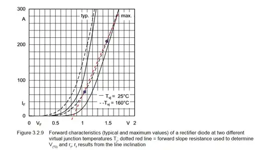

12
The two parameters given are a linear approximation of a portion of the V-I curve of the Schottky diode at a certain junction temperature. Vf0 is a theoretical intercept, not something you can measure directly, whereas rF is the average slope of the curve (in the example curve, between the points of about 65A and 210A, so you need to be able to produce those currents to measure it).
Vf = Vf0 + If * rF
The power loss is the product of the instantaneous forward current and voltage.
Here is information on a different device, illustrating the approximation:
The maximum is going to be higher than the typical, as shown in the curve.
The maximum power loss from forward current will be higher at lower junction temperatures since the forward voltage will be higher, but usually that's not a concern.

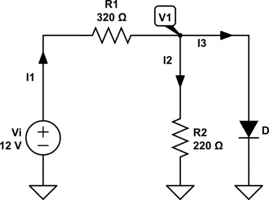

Let's do an example. We are trying to analyze the following circuit:
schematic
When we use and apply KCL, we can write the following set of equations:
$$\text{I}_1=\text{I}_2+\text{I}_3\tag4$$
When we use and apply Ohm's law, we can write the following set of equations:
$$ \begin{cases} \begin{alignat*}{1} \text{I}_1&=\frac{\text{V}_\text{i}-\text{V}_1}{\text{R}_1}\\ \\ \text{I}_2&=\frac{\text{V}_1}{\text{R}_2}\\ \\ \text{I}_3&=\text{I}_\text{S}\left(\exp\left(\frac{\text{q}\text{V}_1}{\eta\text{k}\text{T}}\right)-1\right) \end{alignat*} \end{cases}\tag5 $$
Substitute \$(5)\$ into \$(4)\$, in order to get:
$$\frac{\text{V}_\text{i}-\text{V}_1}{\text{R}_1}=\frac{\text{V}_1}{\text{R}_2}+\text{I}_\text{S}\left(\exp\left(\frac{\text{q}\text{V}_1}{\eta\text{k}\text{T}}\right)-1\right)\tag6$$
For the LED, let's use parameters taken from a Luminus PT-121-B LED: \$\eta=8.37\$, and \$\text{I}_\text{S}=435.2\:\text{nA}\$. (Assume \$\displaystyle\text{V}_\text{T}:=\frac{\text{kT}}{\text{q}}=\frac{8094745087}{320435326800}\approx0.0252617\:\text{V}\$, of course.)
So, we need to solve:
$$\frac{12-\text{V}_1}{320}=\frac{\text{V}_1}{220}+435.2\cdot10^{-9}\cdot\left(\exp\left(\frac{1}{8.37}\cdot\frac{320435326800}{8094745087}\cdot\text{V}_1\right)-1\right)\tag7$$
Using the known values, we find:
$$\text{V}_1\approx2.27078\space\text{V}\tag8$$
So, for the power we get:
\begin{equation} \begin{split} \text{P}_\text{D}&\approx2.27078\cdot435.2\cdot10^{-9}\cdot\left(\exp\left(\frac{1}{8.37}\cdot\frac{320435326800}{8094745087}\cdot2.27078\right)-1\right)\\ \\ &\approx0.045602\space\text{W} \end{split}\tag9 \end{equation}
I solved for all the knowns using Mathematica. The code is given below.

Out[2]={{I1 -> 0.0304038, I2 -> 0.0103217, I3 -> 0.0200821, V1 -> 2.27078}}
In[3]:=2.270777378007583(Is(Exp[(q*2.270777378007583)/([Eta]kT)] - 1))
Out[3]=0.045602
