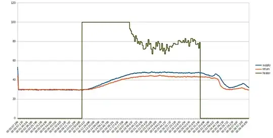

The first test I did was already successful with the following settings:
  • SetPoint 55°C
  • P 10
  • I 2
  • D 10 test1
The target temperature of 55°C is never reached, but I'm very happy with the stable heater results. The heater is using around 80% power which results in a stable temperature output.

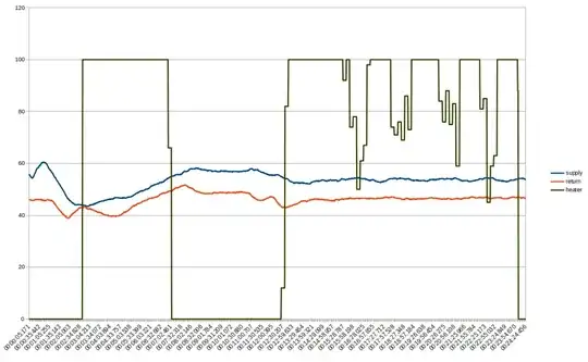

I performed more tests to see if I can tune the settings to reach the SetPoint, but I discovered that the heater control becomes more unstable (fluctuates between 50% and 100%) with these settings:
  • SetPoint 55°C
  • P 82
  • I 25
  • D 70 test2
This can be explained because I'm using the output of the PID to control the heater. So the closer it gets to the setpoint, the smaller the PID output. But to keep the temperature at 55°C, the heater probably needs to be at 90% power. So how do I finetune the system? I'm thinking about:
