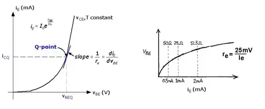

Well to be more precise \$r_e\$ is defined as \$r_e = \frac{dV_{BE}}{dI_E} = \frac{V_T}{I_E}\$
If for example, you take and plot the \$I_E = f(V_{BE})\$ or \$V_{BE} = f(I_E)\$
You will get this
As you can see \$r_e\$ is the slope of \$V_{BE} = f(I_e)\$.
This means that the \$r_e\$ is a "property" of a transistor alone.
And we can "replace" when doing small-signal analysis the nonlinear base-emitter diode with an ordinary \$r_e\$ resistor. And analyze the circuit using the linear network analysis technique we well know and understand.
Here is an example: pi model of common collector
Additional because \$\frac{I_C}{I_E} = \frac{\beta*I_B}{I_B + \beta * I_B}=\frac{\beta}{\beta +1}\$
And that the typical \$\beta\$ value is much large then \$50\$ we can say that \$I_E \approx I_C\$ and use the simplfid equation \$r_e \approx \frac{25mV}{I_C} = \frac{1}{g_m}\$
