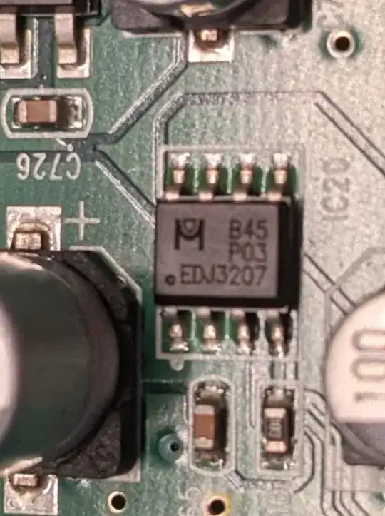

I believe this to be a voltage regulator of some kind (it's failed, and is resulting in a dead short straight through). However neither I nor Google Image Search is having any luck identifying the manufacturer mark. Does this look at all familiar to anyone?
(If anyone knows what the component is, that'd be even more awesome, but at least with the manufacturer I can look it up in their catalogue. Google doesn't know what a EDJ3207 is either, by the way.)

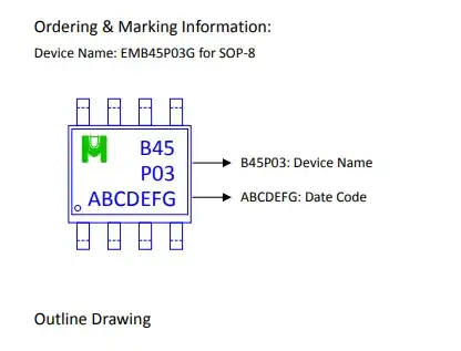

  • Most parts will have both a part number and a date code marking. While formats vary, the most common date-codes include the week within the year and the last two digits of the year, usually written as wwyy. The date code is most commonly below or after the part number. With this information in mind, the markings on that chip can separated into the "B45P03" most likely being the part number and the "EDJ3207" containing a date-code indicating that it was manufactured in the 32nd week of 2007. That this interpretation is correct can be verified in the datasheet which you have already obtained. – Makyen Jun 26 '21 at 20:25

While I was writing up the post someone looked over my metaphorical shoulder and said 'oh, yes, that's an Excelliance P-channel MOSFET, probably the EMB45P03' and handed me the datasheet. Sigh.
https://datasheetspdf.com/pdf/1111730/ExcellianceMOS/EMB45P03A/1

Excelliance EMB45P03G is the correct part number:
A 30V 5A logic-level P-channel MOSFET.
