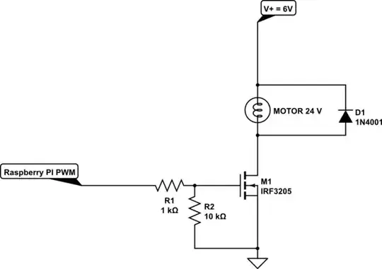

I'm using Raspberry Pi 3 b+ to generate PWM signal at (pin 8) which connected to MOSFET gate through 1 kΩ resistor as the schematic shows:
schematic

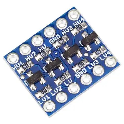

    First I tried to use 3.3 to 5 V converter to amplify the PWM signal to 5 V but this made things worst the MOSFET getting hot faster than before.
3.3 V to 5V logic level converter photo:

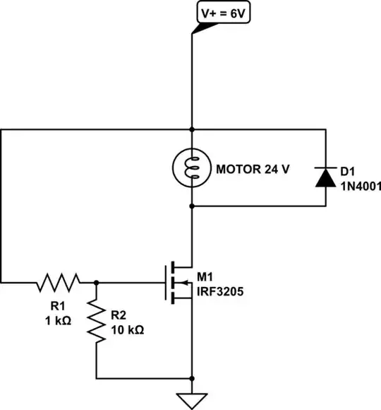

As a test I removed the PWM signal wire from gate and use the V+= 5 V instead , the motor spins and the MOSFET has a reasonable amount of heat.
Here is the schematic:
schematic
simulate this circuit
Conclusion : The reason of the heat is the PWM itself, the ON/OFF effect is the reason of the heat.

  • Your gate drive is not enough, the data sheet for the MOSFET will let you know how much gate voltage you need. It is normally in graph form. Also move your 20K resistor to the other side of the 1K resistor which you will replace with something in the 100 ohm range. That may cool it down a bit. – Gil Jun 16 '21 at 02:38

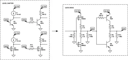

You can buy gate driver ICs or you can make your own from discrete transistors in push-pull or totem-pole configurations
  • if you choose to use MOSFETs in the level shifter they need to be logic level or else you will obviously run into the same problem you are trying to solve
  • as drawn below, the PMOS must have |Vgs max| > 10 or 15V since that is what it will be when its gate is pulled LO by the GPIO. Otherwise zeners and resistors to clamp the PMOS Vgs to tolerable levels need to be added.
  • You want these MOSFETs to be small so they have low gate-source capacitance and can respond quickly to the weak GPIO.
schematic

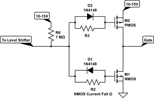

CORRECTION FOR SCHEMATIC ABOVE: 1MOhm resistor on gate driver input should be pull-up, not pull-down. Website has glitched out and I can no longer edit the schematic.
In the level-shifter, a current source or active pull-up (made of transistors) will be faster than a pull-up resistor since no RC time constant which will in turn switch your gate driver MOSFETs more quickly (if you are using MOSFETs in the gate driver stage).
The 5 Ohm resistors are there to limit shoot-through since both gate driver transistors are being driven by the same control signal so there is no guarantee they won't both be moderately conducting as one turns off and the other turns on.
Depending on the details of the transistor you are using and how the drive for them exactly turns out, you might be able to remove the 5 Ohm resistors and just tolerate the shoot-through current if it is small and fast enough.
Another way to deal with shoot-through (when using MOSFETs in the gate driver at least) is to use diodes to route the gate current paths through different components during gate-source capacitance charge and discharge so that the turn off time is faster than the turn on time. This doesn't work with BJTs whose control depends more on base-emitter currents than base-emitter voltage. By the way, this approach works for power MOSFETs in half-bridges and H-bridges as well where you can't use any other shoot-through handling methods mentioned in this answer which rely on throttling power (makes too much heat for high powered circuits). My opinion is you should just use independently controlled gate signals in that case, but for gate drivers no one wants that extra complexity.

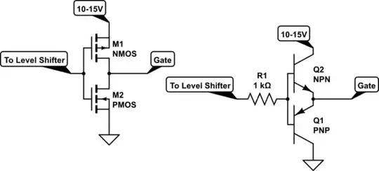

schematic
You can also swap the positions of the NMOS/NPN and PMOS/PNP of the gate driver stage for a configuration with no shoot-through. This makes them act as source/emitter followers, more like amplifiers with a controlled crossover rather than switches. This then allows you to remove the 5 Ohm resistors which are only there to limit shoot-through currents which prevents them from limiting the current charging/discharging your power MOSFET gate-source capacitance. But the price you pay for this is that they won't reach the rail voltage as closely, but without those resistors they will traverse the middle region more quickly.

  • @DKNguyen Your drivers you drew are both not going to work very well; you've put an emitter follower and a source follower when what you need is a switch. – Hearth Jun 16 '21 at 01:36
  • @Hearth I am aware. Just simpler this way because then OP won't need to worry about shoot-through in the gate driver. – DKNguyen Jun 16 '21 at 01:39
  • @DKNguyen But this won't give any higher voltage than the microcontroller can already output. – Hearth Jun 16 '21 at 01:40
  • oh wait I see what you mean. Yeah. – DKNguyen Jun 16 '21 at 01:40

You cannot use 1kR resistor on the gate!! I mean, you can, but then the MOSFET turns on and off slowly, therefore having non-zero power for a longer time in the cycle. And heats up... Use voltage of 5-10V and smaller resistor. Or lower frequency.
Other suggestions are correct but for immediate improvement find a “logic level” fet that can operate with 3.3V gate drive. They’re not the best but they exist.
Change the 1k to <100 ohms and the 10K to 100K or remove it (the divider shown is slowing down the gate drive and dropping the gate drive voltage even further).
