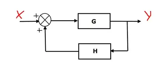

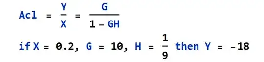

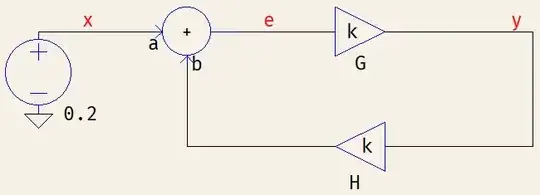

Assume that we have a postive feedback block diagram like this. You can derive the closed loop gain as in the image.
If you replace the numbers with loop gain larger than one, you get a wrong result and does not make sense. The ouput should keep increasing to infinity in theory or to the rail voltages in real life.
I understand that GH = 1 is the stability limit.
You may add some delay in the feedback network but the block diagram makes sense without delay.
My question is just about the theory not about how it happens in real life.
Assume that you're given that block diagram. If you look at the block diagram, due to the loop with loop gain GH >1, the output should keep increasing.
Why can't the equation include that information?
I don't see anything wrong with the derivation and block diagram.
EDIT: There are some answers and comments saying that it is wrong because the system is time varying so you should apply a different method. Then I wondered why negative feedback works while it's also time-varying system. And Eugene Sh. in the comment said "negative feedback works because x(t) will get closer to x(t-delta) over time." However, there is no formal proof for that. Is there a model (maybe with delay) so from that model you can obtain the correct result for both negative and positive feedbacks?

There already are two answers, I'll tackle the part that confuses you.
What you have there is not a "system" -- you have a mathematical equation described, visually, as a block diagram. And because it's represented visually, you're interpreting it as a feedback system. It is not.
As I mentioned the \$G\$ and \$H\$ "blocks" are simply constants, parameters, values that describe an equation, and that equation is: \$y=Kx\$. That's because the fraction \$\frac{G}{1-GH}\$ reduces to a constant, irrespective of what values \$G\$ and \$H\$ take, or how you represent it graphically, as long as it makes up that formula. Therefore there is no loop, no block diagram, just a fancy pictogram for \$y=f(x)=Kx\$. Instead of \$G\$ and \$H\$ you could have \$p\$ and \$q\$, two random variables, and it wouldn't change a thing.
Therefore the result is not wrong, it's perfectly valid. But if you want to have feedback, then you need to account for time, and that comes through the introduction of states and an analysys done in more than one time point, as the other answers and comments explain at large.

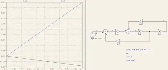

Just for a fistful of giggles, here's another "block diagram" that has the exact same \$y=Kx\$, but with another fancy way of expressing \$K\$ as a combination of 5 elements this time, \$K=-\frac{ABC}{B(AE+CD)-1}\$:
test
As you can see there's no infinity at the end and, despite the absolute positive "feedback", almost all voltages are negative. In particular, see V(y) -- the output of the "block diagram" -- vs V(test) -- V2 with the equivalent "transfer function".
And to take it one step further, here are two more examples about what I've been talking about in my 2nd comment:

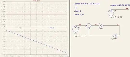

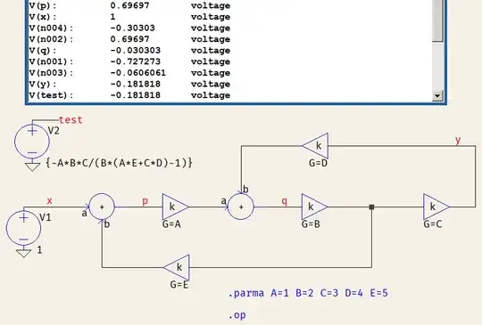

Given your comment it looks like maybe you're not convinced that what you have there is not a "feedback system" but a simple function, so here's another attempt that shows your "block diagram" versus the behavioural source version of \$y=Kx\$:
math
B1 multiplies V(x2) (the input) with K, which is a parameter made up of G's and H's values, 10 and 1/9, respectively. To the left you see them plotted and they completely overlap -- the plot above is their difference: 0.
You don't have a "system", and the only reason why you think it is one is because you represented it with a block diagram. It is not a system, the same way the first example I showed is not one, either.

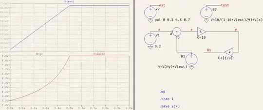

First, the state is a concept about a system's dependence of time: at time point \$t_1\$ there is one value, and at \$t_2\$ there is another, not necessarily different, but who is dependent on the previous one.
As shown, having static values for \$G\$ and \$H\$ means that everything reduces to a simple \$y=Kx\$, but if either \$G\$ or \$H\$ are dependent on time or some other quantity except the previous state, it will still not be a system. Here is the proof:
Let's say \$H\$ is dependent on another voltage. \$x\$ varies with time, therefore it's implied to be \$x(t)\$, so then let \$H=H(t)=f(A(t))\$, where \$A(t)\$ is an external value. If \$A(t)\$ is simply \$A\$, a static value, it all reduces to \$\frac{G}{1-AG}\$, so no change compared to the previous case, while for \$A(t)\$ it becomes:
$$\frac{G}{1-A(t)G} \tag{1}$$
There is nothing special in this notation other than a time dependency. Nothing in this formula shows feedback, positive or negative, since the equivalent \$K\$ is now a simple \$K(t)\$, therefore for any \$x\$ the output \$y\$ will not depend, in any form, of the previous state of \$x\$, or on the previous state of \$A(t)\$ -- it simply follows \$A(t)\$'s value as if it was just a constant, itself. Here's a proof:

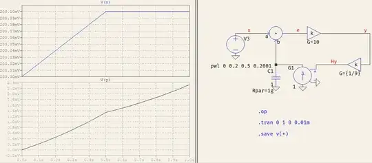

still no system
V2 generates an external signal, varying from 0.3 to 0.7 in 0.5 s, and then remaining at the last value. B1 takes V(ext) and multiplies it with V(Hy), which would be the output after the usual \$H\$ block. As you can see, the output is a linear match for B2, which has the formula in (1). You can see that V(y) and V(test) are completely overlapped.

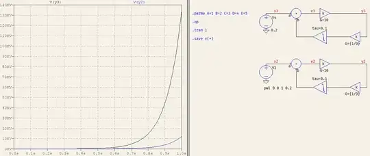

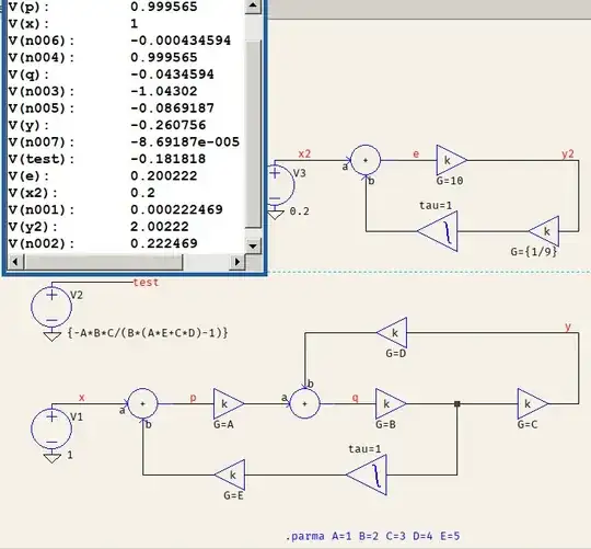

But if you replace B1 with a block that has states, e.g. an integrator, then things change, but only if the analysis involves at least two different time points, and the system is not static -- because, as I've shown before (3rd picture), simply adding a capacitor means that the operating point will be calculated by the SPICE engine and the output will be steady.
In practice there is always noise so instabilities would accumulate. This is a simulation so it needs a bit of user help. It could start by itself, due to the non-ideal nature of the numerical precision, but that, too, requires careful considerations of timestep over timespan, to match the expected changes.
So let's change the input to be an ever so slightly changing ramp, going from 0.2 V to 0.2001 V over 0.5 s, and then remaining at the last value (similar to what V(ext) was):
now
Now look at V(y)! In fact, all that would be needed would be to have the tiniest change in the input, for the tiniest moments (therefore at the minimum two time points), or anywhere in the path, and the output would accumulate. The input, V(x), is plotted in blue, and it shows that it changes only for the first half a second. The output seems to follow linearly the input, but as soon as the input has stopped, the output hasn't. This is what the presence of a state does to the system. Now it's a system.
I said "seems to follow" because it doesn't, it actually blows up (or down, depending on the value of the input), but here the time constant of the state is 1 s so the changes accumulate slowly, but even halving it to 0.5 will show significant changes.
Therefore in order to be a system it needs two things: a state (something that makes the system dependent on its previous value), and an analysis of at least two time points (during which, if the analysis is ideal, there needs to be a slight perturbation). Your "block diagram" has none of these.

As others have stated, the block diagram you have drawn is physically unrealisable, so our physical intuition does not apply here. What you have found by \$\frac{Y}{X}=\frac{A}{1-AB}\$ is a DC equilibrium point of your "feedback" system. It's true that if we feed in an input X and compute the output Y using the aforementioned equation, we obtain a mathematically consistent input/output pair.
For example, if \$A=1\$ and \$B=2\$ and \$x(t)=1\$, then \$y(t)=-1\$. The error signal is \$e(t)=By(t)+x(t)=-2+1=-1\$. Finally, we can recompute the output \$y(t)=Ae(t)=-1\$, which is consistent with the original "transfer function" equation. So far so good. Note that I'm performing these computations in the time domain, since there is no actual time dependence involved (the results are the same in the Laplace domain). All this is saying is that your block diagram represents a system of linear equations which can be represented as an invertible matrix (as long as \$1+AB\neq0\$).
Now we get to the problem at hand: this system is physically unrealizable, but what if we perturb the input from its equilibrium state? Using the previous example, let's apply \$x(t)=1+\delta\$ for \$t>0\$ where, say, \$\delta>0\$ (the same analysis could be applied for negative \$\delta\$). If the output \$y\$ somehow found its way to \$y(t)=-1-\delta\$ for \$t>0\$, the system would once again be consistent. But does this actually happen in a real system if we introduce an infinitesimal amount of delay into the loop? If we apply the \$\delta\$ perturbation to \$x(t)\$ at \$t=0^+\$, the error signal will be \$e(0^+)=-1+\delta\$ which will push \$y\$ more positive. This is the opposite direction the output should move in order to reach the equilibrium point. Repeating this process (recalculating \$e\$ and \$y\$) should make it clear that this system is unstable.
In order to perform this perturbation analysis, we had to assume that the system does not respond instantaneously, which is the case for physically realizable systems. For the case in the question, there are no dynamics, so the only mathematically consistent \$x\$ and \$y\$ pairs are constants for all time. Instability in the usual engineering sense requires a dynamically changing output that tends towards infinity (it's not just a "DC" infinity), so this static system cannot be unstable in that sense.

Short and simple answer: The result is not "wrong" - it is correct.
You can prove it by hand calculation or by simulation. However, the result assumes that there are absolutely no external (perturbing) influences - and this assumption is very unrealistic (noise, temperature and power supply variations).
As a mechanical analogon you can think of two balls - the smaller one is riding upon a larger one: No problem under ideal conditions (which never can occur). However, the smallest mechanical disturbance (e.g. air movement) will destroy this stable system.
Remark: Regarding simulation, only a TRAN simulation (time domain) or a variation of the DC power supply will reveal the unstability of such a system. Note that any ac simulation cannot reveal such instability.
Special case: Note that a realistic system with pos. feedback is not always unstable. For a pos. loop gain LG between zero and unity (0<LG<1), the system is stable (reduced bandwidth). The oscillation condition is at LG=1 and for LG>1 we have saturation.
