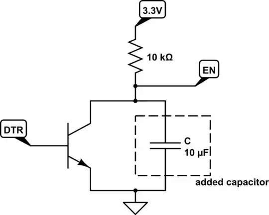

I found the schematics for that ESP32 board on this page:
https://github.com/espressif/arduino-esp32/issues/544
Schematics: https://github.com/espressif/arduino-esp32/files/1215494/SchematicsforESP32.pdf
Here is basically what's going on:
schematic
The Arduino IDE brings DTR high in order to signal the ESP32 that it wants to upload a new firmware image. The intent is to bring EN low. However, the software is likely bringing DTR high for too short of a time.
With the cap added bringing DTR high for even a very short time will quickly discharge the cap. It will then slowly charge back through the 10K resistor. This means that the EN line will remain low for a longer period of time.
