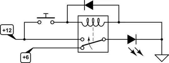

You could have the pedal activate a relay...
schematic
The relay should be a 12 volt relay. For the diode a 1N4007 would do the job. You can read more about selecting flyback diodes in this question:
How to choose a flyback diode for a relay?
One drawback is that the 6-volt buck regulator is running all the time, even when the pedal is pressed, but it seems that the pedal is pressed only infrequently, so the +6V power supply is needed most of the time anyway.

  • Also brilliant and exactly what I had in mind! But I think Kartmans version is a little more simple and easier to mass produce! Thank you so much for your time and input – Nicolas Harper Jun 06 '21 at 22:11

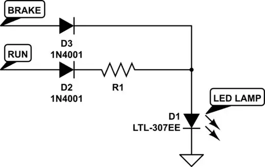

Assuming this is the average brake light in a vehicle, the diodes will need to be chosen for the required current and the resistor value calculated to give the required dimming on the lamp
schematic
Kartman

  • BRILLIANT! Very simple and this will get the job done! Thank you so much! – Nicolas Harper Jun 06 '21 at 22:11
  • Just to note that the diodes are required, otherwise you can get weird issues with backfeeding and ‘sneek circuits’ (unintentional circuit paths). – Kartman Jun 06 '21 at 23:37
  • definitely! I had this same idea but didn't know what was required to prevent the back feeding issue. Thank you for helping me solve this! – Nicolas Harper Jun 07 '21 at 00:18
