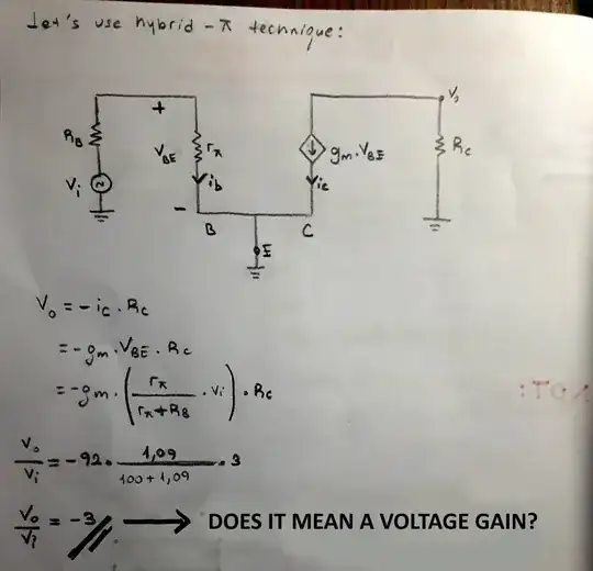

I just have solved one of the bjt common emitter question below. However, I'm curious that how can I additionally find those things below:
1) Input and Output Impedance
2) AC Gain

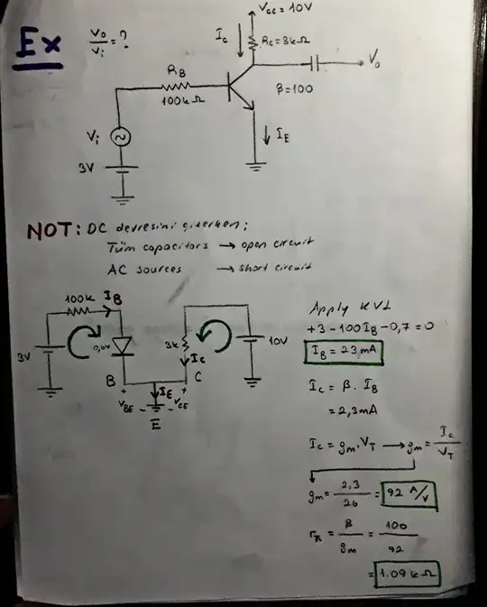

Here is the example and my hand draw solution. However, the question only asked to find Vout/Vin...
Also, my 3rd question is, Does Vout/Vin (I calculated as -3) mean voltage gain?
Another my 4th question is Does voltage gain mean mean AC gain? Or, what is AC gain exaclty? I am not sure
I will be enormously happy if you satisfy my curiosity and show me the right way...
Also, if you have suggestions to solve this question in a more usable way, I am open to listen your suggestions.
I'm just secondary class student, that is why I try to figure out with questioning...

  • Yes, - 3 is an AC signal voltage gain. $A_V = - \frac{\beta R_C}{R_B + r_\pi} \approx \frac{\beta R_C}{R_B} \approx -3 V/V$ And can be calauclate using this : Rin = Vi/Ii Can you do it? As for the Rout see this https://electronics.stackexchange.com/questions/464496/measuring-input-and-output-resistance-of-the-hybrid-model/464516#464516 or this – G36 Jun 03 '21 at 18:46

  • But you did manage to find the DC base current. Now to find Rin you need to do exactly the same thing as you did before , but now you need to find $i_b$ on a small-signal AC equivalent cirtcuit. For your circuit we have: $ \Large v_i = i_bR_B + i_b r_\pi = i_b(R_B + r_\pi)$ Thus, $\Large R_{in} = \frac{v_i}{i_{in}} = R_B\ + r_\pi$ is that clear to you? – G36 Jun 04 '21 at 18:34

  • And to be able to find Rout you need to find the resistance "seen" from the "load resistance point of view" In your circuit, there is no load (open circuit RL = 00). Now let us look at Rout. If we are looking from the load perspective we can see two paths for an AC current to flow: https://i.stack.imgur.com/37b8O.png The first one ---> into Rc resistor and the second one into the BJT's collector terminal. If we ignore the Early effect. The Collector AC resistance (dynamic) is equal to infinity. Thus Rout must be equal to Rc resistance. – G36 Jun 04 '21 at 19:45
  • Or we can use this small-signal diagram and solve for Rout. W can do this by placing a test voltage source (Vx) at the output (we set Vin = 0V) and solve for Ix. And Rout = Vx/Ix https://i.stack.imgur.com/o8OiD.png And I hope that you see why Rout = Rc, because Vin = 0V there is no base current. Therefore Vbe = 0V and Ic = gm*Vbe = 0. So, Ix = Vx/Rc ---> Rout = Vx/Ix = Rc. Any additional questions about it? – G36 Jun 04 '21 at 19:45
