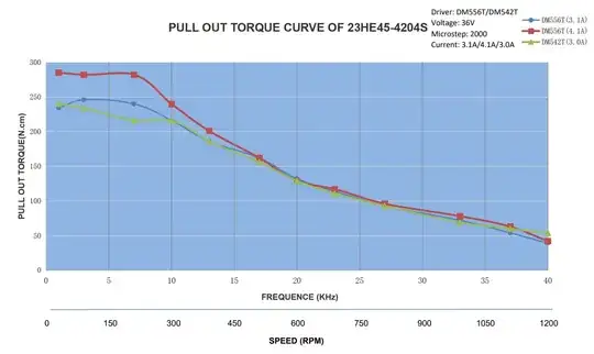

I have found the torque VS. speed chracteristics for one of your mototors.
You can see that using 36VDC supply and 4.1A per phase, this motor is usable until approx. 350 RPM. With lower voltage (24V) it's even less, approx 250 RPM. Speaking in pulses/sec for a number of 2000 microsteps per revolution, you see that at 40.000 pulses/sec it outputs very small torque. I guess that with 24VDC at 3200 microsteping and 65.000 pulse/s it stalls as you already discovered. So nothing wrong with your Teensy and your work.

Think about the inductance. You have a voltage of 24 volts, and voltage across the inductor is L*di/dt. So your peak phase current is reduced as you step more quickly. Your "no load" condition is actually loaded by the rotor's inertia, which must be accelerated from at rest to move to the next position before the next step arrives. If it doesn't get there, the rotor falls back and just vibrates. You must get adequate current, and your torque load is also increasing as the required acceleration increases to get you moving to reach the next position.
There are two means available to run a stepper faster. One is to apply a higher voltage (be sure to current limit). Steppers run in this fashion are prone to heating even with no load on the shaft because the acceleration and deceleration of the load requires energy.
The second approach is to use feedback and speed control to take advantage of the rotor's angular momentum. Many charts like the one supplied by @MarkoBursic which show a maximum stepper speed take advantage of the "sweet spot" at which little energy is lost between steps. This approach gives you higher speed, but at the cost of the added complexity. You also will have to accelerate and decelerate smoothly, adjusting your duty cycle to match the rotor speed.
