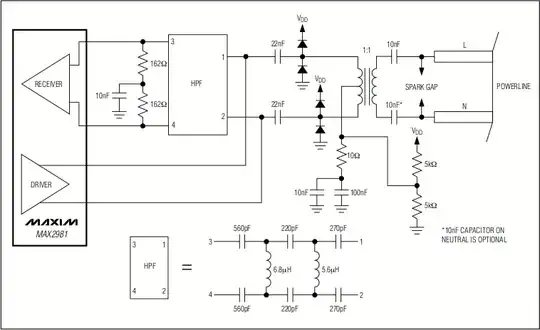

You can insert/remove high frequency information from the power line with a simple isolation transformer specced for your frequency (look in the pulse transformer section) and a high pass filter on the receiver side.
Example from one of Maxim's datasheets: alt text

  • So how do you insert this info into the line - do you pulse it at the desired frequency? Doesn't this mean the adapter has to create a current that devices will consume? – Thomas O Oct 26 '10 at 17:55
  • @thomas check my edit – Mark Oct 27 '10 at 00:45
    As to the current consumption, yes there will be some, the receiving ends will be high impedance and shouldn't draw much current but the sending end does have to source current. It sounds to me like your not thinking about these issues in the frequency domain. Current flowing in one direction providing power on a signal line doesn't mean that current can't flow in the opposite direction at a different frequency into a different load at the same time. Remember electron drift at AC is almost zero, electrons aren't moving (much) your transferring energy through fields. – Mark Oct 27 '10 at 00:57
