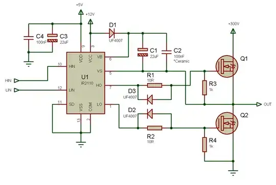

I have been working on a half bridge Tesla coil circuit. In process of building the Tesla coil, I have come across some problems.
First of all, I’m using the IR2110 gate driver IC to drive the MOSFETs. The logic supply voltage is around 5 V, the gate drive supply voltage is 12 V. The frequency is 450 kHz. The high input duty cycle is 60% and the low input duty cycle is 30%. The problem is while checking the gate to source voltage of the high side MOSFET I have found out that the voltage is only 4.5 V.
The low side MOSFET only receives 3.5 V considering the supply is constant 12 VDC.
There are some changes in components:
  1. The bootstraping capacitor is a 3.3 uF electrolytic capacitor paralleled with a 100 nF ceramic cap.
  2. The diodes D1, D2 and D3 are FR207.
  3. Q1 and Q2 are IRF540N N-channel 100 V MOSFETs.
For the inverting and non-inverting signals I used the 74HC14 hex inverter to the signal high and low for the IR2110 hin and lin. I don’t know what is causing the problem.

    What DC voltage do you measure across bootstrap capacitor C1? I would remove the large (IRF540) MOSFETs and then connect OUT directly to Ground. Apply the input signal. Then at HO and LO there should be a 12 V signals (HO about 11 V), are there? If not, your IR2110 might be broken. – Bimpelrekkie May 31 '21 at 15:06

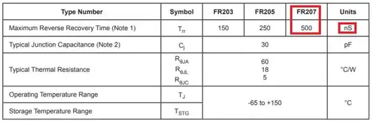

the diode D1,D2 and D3 is FR207
That is a significant problem. They need to be fast recovery diodes and not sloppy standard recovery diodes: -
If your switching frequency is 450 kHz (a period of 2.222 us) then those diodes are conducting in reverse for a significant time and eating the energy of your circuit. The UF4007 on the other hand has a reverse recovery time maximum of 75 ns i.e. about 7 times better than an FR207. There are reasons why fast diodes are used.

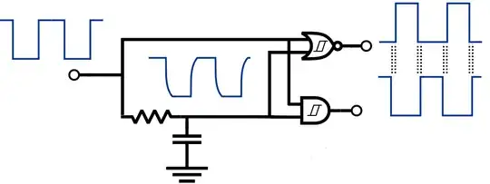

There may be other problems such as not having an accurately drawn schematic and relying on text to modify the components shown - which of course makes me suspicious that you are out of your depth. Or this: -
for the inverting and non-inverting signals I used the 74HC14 hex inverter to the signal high and low for the IR2110 hin and lin
Depending on what you have done here you may get significant shoot-through. You don't want any possibility of overlap between high states for HIN and LIN. Consider using something like this to reduce that unwanted situation: -

  • Okey i will change the diodes to uf4007 use the nor/and gates with schimmit trigger function – Mr. Infinite Jun 01 '21 at 05:43
  • @Mr.Infinite maybe you should take the tour to understand the motivation behind folk giving time to help. – Andy aka Jun 01 '21 at 09:05
  • Andy aka-ive changed the diodes to uf4007 and the high output works perfect and upon testing i found out that my 74hc14 hex inverter is the culprit the transistors are on for some time,thus momentarily shorting the supply im going to change the circuit as you sugested and any sugestion for the capacitor and resistor value – Mr. Infinite Jun 01 '21 at 12:04
  • Yes sir i did took the tour as you mentioned – Mr. Infinite Jun 02 '21 at 01:57
  • R*C should produce a time constant that covers the potential overlap period. Maybe go for 25 ns - 100 ohms and 220 pF produces an RC time constant of 22 ns. – Andy aka Jun 03 '21 at 12:13
  • thank you i will try it out accordingly.i have purchased the logic gates they should arrive soon – Mr. Infinite Jun 04 '21 at 13:47
