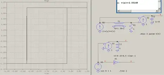

As you found out yourself, parametric plots can't be integrated, but there is a way to do it. Mathematically, the Y axis would be \$b(t)\$ and the X axis \$h(t)\$, and they're both functions of time. To find out the area uner a curve, you take the integral over an interval, but since \$\mathrm{d}t\$ is now a function, itself a function of \$t\$, it all becomes:
$$A=\int_0^T{b(t)\mathrm{d}h(t)}=\int_0^T{b(t)h'(t)\mathrm{d}t}\tag{1}$$
Therefore you have to take the derivative of H and multiply that with B in order to have in integrated (without the need for a parametric plot):
test

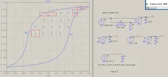

In the plot, one square is 0.3*10=3 units, and a crude approximation count is about 18*3*2=90. It's clear that I'm underselling, but whether there are 4 more... However it is, B1 does what's described above, with V(h') being the derivative, and the rest is a way to apply definite integration. The .meas script shows -111.5, which is greater than the crude approximation by about 20% (which is better than 50%, I suppose), and it's a negative value because the product turned out this way, so it's just a matter of sign.
Word of caution: because you are using a derivative, if H is wild then the derivative will be even wilder, so don't forget to check the signals before pointing a finger.
Or you could try to use the formulas described in the help, under LTspice > Circuit Elements > L. Inductor (though they'll need to be used as a parametric plot).
Because it's difficult to determine the accuracy of the results above, it's never a bad idea to use a simpler approach. For example [Digital]/schmitt* for the hysteresis, and for the input a sine, since it needs to be differentiated. The plot shows the hysteresis window as being from -1 V to +1 V on the Y-axis, thus 2 V tall, and from -0.5 V to +0.5 V on the X-axis, thus 1 V wide, making its area 2. Just like above, G1+L1 differentiates the input giving V(z), which is then multiplied by the input, V(x), to be integrated (continuously) over a period (T1 with Td=1, since V(x) is a sine with period of 1), giving V(A) as the result, shown with a .meas script.
simple
The output is still negative, because the multiplication starts with a negative number. The value is what matters.
I started this as a comment, but it looks like it will take a bit more.
Don't you think that the problem becomes from the mathematical definition that we took at the beginning of your post ?
Not at all. As I said in a previous comment, by not imposing initial conditions you are relying on LTspice to find the appropriate operating point for all the elements, which happens to be non-zero for the initial time. This is because when there are no initial conditions, the SPICE engine considers that the circuit has been running since the dawn of time, and when the user presses "run" what is seen is the steady-state as determined by the solver.
Given your circuit: I1 starts with a 100 A. This, alone, is an abomination if you consider that everything should have started at zero, but let's follow this thread. The solver considers that the circuit has been running since the Big Bang so when "run" is clicked, the whole circuit must behave as if I1 and the rest of the circuit has reached the 100 A value in a decreasing ramp. This ramp feeds an inductor, whose voltage feeds an integrator and its current a voltage source, and other mathematical operations based on these quantities. Therefore the solver must figure out what happened until the user clicks "run" such that at t=0 everything should be as close as possible to what exists in the schematic.
Because of the above, the integrator doesn't start at zero, but that's no reason why the formula is wrong. Hmm, looking over the whole answer and the coments, I see I forgot to mention this. I'm sorry. When performing indefinite integration and you're interested in the result over one period, you have to treat it the same way you would treat an integration with initial conditions: subtract the value at the beginning of the interval from the one at the end of it.
The same thing needs to be done here: V(Energy_loss) starts from 7.0443931 kV (as shown by the cursors) and wobbles to the final value of 7.0444878 kV, which means the difference is 94.726563 mV. It makes sense since your hysteresis has non-zero width. If you duplicate B4 and modify its expression to contain my other suggestion in the comments, idt(V(b), delay(V(b), 400)), you'll see that it settles at the final value of 184.24845 mV. Which is acceptable given the imposed timestep that the waveform compression is on.
I also hinted at behavioural sources vs primitives in the comments, so if you'll use the circuit shown below then this is what you'll get:
comp
Take a bit of time to see what is shown:
  • Top right there's the error log showing the results of the .meas scripts seen in the bottom-right. The difference between what B4 (not shown but present in the schematic as giving V(Energy_loss)) is showing as ve=ve2-ve1=-0.41 (with the same timestep and .opt), vs V(test2), which uses the derivative as given by G2+L2, as vt=vt2-vt1=0.02, is more than an order of magnitude. And this is considering that the quantities are kV (don't forget that this is a SPICE engine, which deals in tolerances, not precision).
  • Plotted are V(energy_loss_2), which is my suggestion of a definite integral with a behavioural source (the idt(x-delay(y)) thing), vs. V(test) which is the version made out with primitives (and a B source). The readings are with the cursors shown in the top left, and they show 492 μV for the first and 6.8 nV for the second. Now use the parametric plot for the B-H curve and zoom in around zero. A simple click-drag rectangle will show about 9.6 mV on the X-axis and about 0.8 μV on the Y-axis. Multiplied they should give nV.
I conclude that the formula is very much valid, but also that it matters how it's implemented. If you want to see for yourself, here is the new source (sorry about the way they're thrown in, I just separated them for the screenshot):
