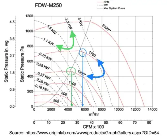

Reducing Fan current consumption - Applicable for most Fans, Blowers and Centrifugal Pumps:
Imagine you could reduce the motor Speed (and Voltage) to 80%, the Flow would also reduce to 80% of nominal (unregulated).
Torque (and Current) required by the Fan would then be (RPM80%/RPM100%)^2 = 64% of “nominal”, here about 3~4A.
Power needed would be even less, just 0.8^3 = 51% of nominal.
This means that if someone reduces the Speed slightly to 80%, it would be the same as Doubling the battery runtime, as the power is just half of nominal. In this case you might not even need to use Two Batteries. The following graph exemplifies with actual Fan numbers what would happen if one reduces the power speed to this 80% of nominal (as 1700 rpm there). Compare arrows of Power (Bold Green) with Speed (Bold Blue):
So, if you can use a Switched Mode CV module (as that “5A” rated module XL4015, but with extra Heatsink glued and near the Fan), you could adjust the Fan’s voltage to about 9V~10V and reduce the current consumption, doubling (or more) the running time.
Don’t limit directly the motor current, just the voltage: Startup and Acceleration torques demand higher currents than steady-state speeds.
When the Powerline returns, this reduced-power mode could be bypassed (manually, by relay, etc.) to resume nominal fan speed, while recharging the battery without overcurrent and preserving your Power-supply/charger from overload.
