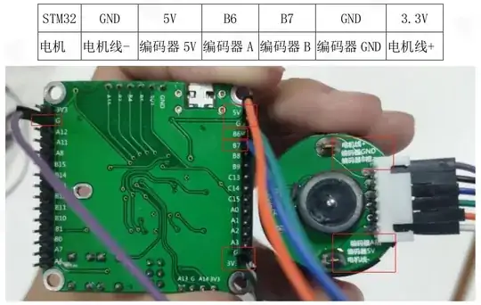

The motor has 6 pins, which are shown in this image from the docs (where it is connected to some unknown and ungoogable STM32 board):
motor connected to some STM32 board
The pins, top to bottom in the picture, and right to left in the table google translate to the following:
wire color english STM32 pin
violet Motor line + 3.3V
black Encoder GND GND
blue Encoder B B7
green Encoder A B6
orange Encoder 5V 5V
white Motor line - GND

Encoder is a sensor that you use to determine position and speed of the motor.
In this case, it's a Quadrature Encoder, which outputs 2 square wave signals form the A & B channels. These two signals has 90 degrees phase difference and it allows you to determine the direction of the rotation.
You connect A & B signals coming from the encoder into the input pins of your uC. If you have supplied signals from your output pins, you may have damaged them.
Most of the times A & B pins are open-drain outputs and need pull-up resistors to work.
BTW, it's not a stepper motor. It's just a permanent magnet brushed DC motor with a quadrature encoder.

  • Thank you! Obviously a noob question, but how do I control it then? By changing the voltage direction and magnitude to the motor + and motor - pins? Like using L293D motor driver controller? – psarka May 29 '21 at 09:51
    Yes, you can just use + & - pins with a H bridge (like L293D). You don't need encoders for open-loop control. If you need to read the encoder, STM32 timers can be configured to count encoder pulses automatically. For other uCs with no encoder reading hardware, you will probably need 1 or 2 external interrupt pins and some logic in software to determine the direction. – Tagli May 29 '21 at 09:57
