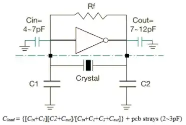

After web researches and a first discussion about general comprehension, I am a bit lost with the load frequency calculation:
I see a design which uses two 33pF external capacitors (C1 and C2),with a uC which has two 4pf input capacitors (Cin and Cout) and with an guesstimated stray capacitance of 2pf, the above formula gives a c_load = (4+33)*(4+33)/(4+33+33+4)+2 = 20.5pF

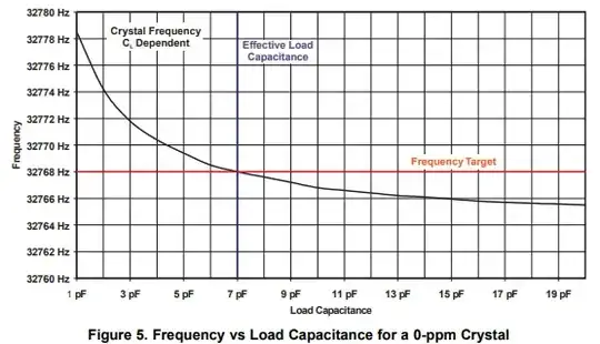

Even if load capacitance specified is not respected here, I am surprised that the load frequency is such far from the frequency expected. Indeed, this not the same order of magnitude as it can be pointed out at TI application report , as shown below, where the frequency drift is more about some Hz or ten of Hz (note: this is an example, quartz characteristics are not the same)

I have found another formula here, as shown below, but the result (Fs = 26 070Hz and FL=28 292Hz) are still really far.
