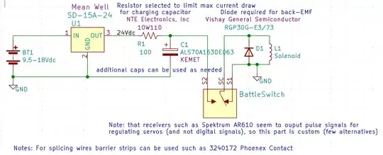

Given limited details, I am assuming that receiver is something similar to Spektrum AR610 receiver. These types of receivers don't output high/low digital signals (at least, I couldn't find reference on how it could be configured this way). Instead, they output a pulse signal used by servos to drive servo horn position.
I doubt 12Vdc will provide enough force to quickly launch hockey puck. Suggest driving solenoid (o at 24Vdc and using capacitors to store energy required. BattleSwitch or Picoswitch allows for relay functionality from receiver channel ouput. Example schematic shown below:
example schematic

  • I am trying to get more info on the ESC and receiver we used. Based on our trials 12vdc worked well when just momentarily touching solenoid wires to the battery – jayj May 23 '21 at 16:34
  • When we added the ESC to act as our switch, we had to jump up to 24vdc to get a higher velocity. But it seemed like it was still slower than the direct connection. – jayj May 23 '21 at 16:39
  • I'd recommend measuring voltage across solenoid terminals (after steady power-on only, as voltage spikes during turn-on could damage meter) to check voltage drop due to switch. It's likely ESC and wires are causing large voltage drop. Related info link – Ernesto May 23 '21 at 23:28
