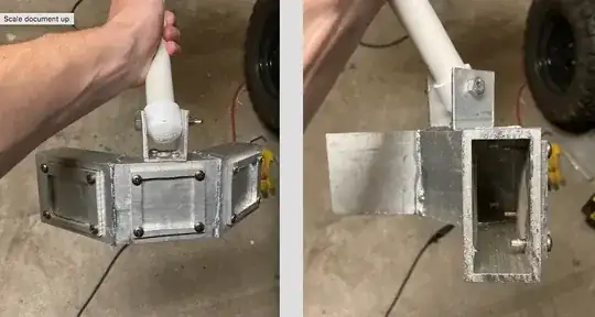

I'm making progress on building a portable light for my kayak.
It will use 3 of following chips: 50W, 12V chips.
The battery will have to be portable so I'm planning to wire them in parallel. I calculate 11.25 Ah needed so thinking to get the battery between:
  • 12V, 14Ah
  • 12V, 18Ah
  • 12V, 35Ah
It is just going to depend on weight.
Each light will be in an aluminum housing and only turned on under water.
I've read about the troubles with overworking one LED when in parallel. Can I put a resistor before each of the 3 lights and if so, can someone direct me there?
Also, can I add switches to each light to conserve battery without overworking? That is, only turn on the lights I need?

  • This isn't a novel concept I'm building as folks use these lights fairly often on the coast...here is an example: https://afishnsealights.com/collections/batteries/products/double-trouble-with-pole I was looking to build one to my specs and will be mounting the chips to 4in sections of 3/16" aluminum rectangle tube. Should I additionall add heatsink material to the back of the rectangle tube if they will be submerged? – user3310766 May 16 '21 at 17:14
  • Just looking for confirmation as I'm learning here...so all will receive 12v in parallel...I just need to ensure I have enough amps to 1) power them e.g. >11.25ah and 2) enough to run them for the desired amount of time. So for example, 35ah will run them for ~3hrs and 14ah will run them for ~1.24hrs. With the switches in place, it will prevent one chip from taking too much current? i.e. not the same as running all 3 lights on and one being burned out? – user3310766 May 16 '21 at 17:23

  • You’ll need a 100W heatsink on each one and best to get and 15A adjustable Buck regulator for 14.7V Li Ion and everything must be cool not enclosed and water proof. silicone spray helps but hurts magnetics from capacitance added and also reduces light intensity but electromigration damage to substrate. If you don’t follow my advice run dimmer to avoid thermal runaway selfdestruction.. – Tony Stewart EE75 May 16 '21 at 17:40
  • Stewart...just added a picture...assuming its water proof and staying submerged, do you imagine addition heatsinks needing to be added? – user3310766 May 16 '21 at 18:23
    As long as both conditions are true. Ok. – Tony Stewart EE75 May 16 '21 at 19:49
  • I’ve used 50W LEDs under water and it works very well for heat dissipation. I’d suggest using about 3mm (1/8”) aluminium, which is thick enough to ensure that the LED has a flat surface to contact. A 100mm (4”) square is adequate and needs no fins, provided you can be sure that the LEDs will be constantly submerged, or at worst not out of the water for more than a second or two at a time. – Frog May 16 '21 at 20:09
  • @Frog, do you run them parallel or just use one? I added photos and I’m using 3/16” rectangle tube – user3310766 May 16 '21 at 20:29
    I’m using high voltage LEDs (56V) but the same power rating. 3/16” box section should be fine. If the heat sink has water-cooling on the back then in some ways thinner is better, but 3/16 is good. – Frog May 17 '21 at 06:01
