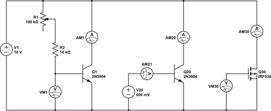

schematic
Consider the circuit above. Let's say R1/2 together are about 100k, so a current of approximately 10 V/100k = 100 uA flows into the base of Q1. Let's say that the hFE is 100. This means that whatever emitter current flows, 1% of it will flow through the base. If the emitter current is zero, then with 100 uA flowing in through R2, the base-emitter capacitance will charge rapidly, and eventually reach a voltage where some emitter current will flow. The base voltage will stop increasing when the internal emitter-base current reaches that of the externally applied current through R2. If we open circuit R2, the internal emitter-base current will rapidly reduce the base voltage, and the emitter current will stop flowing. It's this behaviour of emitter (and hence collector) current in response to base current that means it's completely valid, and often useful, to regard a BJT as a current controlled device. Over many orders of magnitude, the 'output' collector current is around β times the base 'input' current. VBE tends to be in the 0.5-0.7 V region for the sort of base and collector currents that we use in practical circuits. It's possible to estimate fairly closely what all voltages and currents in this circuit are going to be.
If we reduced R1 to zero, then we would observe about 10 times the base current flowing, and also about 10 times the collector current flowing. That's a good enough argument (if it happens, it must be true) for most people to say that a BJT uses a small base current to control a large collector current, and that it's a current amplifier.
In the second circuit, Q20 is driven by a 'stiff' voltage source that controls the base voltage. The base will draw a current, which we can measure in ammeter AM21, of about 1/100th of the emitter current. If we alter the base voltage slightly, by a few 10s of mV, or the temperature slightly, the collector current will vary exponentially over many orders of magnitude. With the 600 mV indicated as the input voltage, I can't estimate to within a factor of 1000 either way what the collector current is likely to be. We need to operate any circuit like this with emitter feedback, or differentially with respect to another similar transistor, to get any stability at all with temperature. If used differentially, it works best in an integrated circuit, where the two transistors are built in the same way, next to each other.
If we assume some stable DC biassing, and look at the variation in base voltage causing a variation in collector current, then we arrive at the gm model of a transistor, and we regard the transistor as voltage controlled.
On the right we have a truly 'voltage controlled' device. As the gate is insulated from the conducting channel in the device, we can apply a gate voltage, which will induce a drain current to flow. The gate voltage will only change through an external current or leakage in the device, not the device's normal operation.

  • Neil_UK, why do you think that "......the VBE would quickly drop..." ? I rather think that in most applications the base-emitter voltage VBE is externally applied and kept as "stiff" as possible (low-resistive voltage divider in conjunction with emitter feedback). – LvW May 13 '21 at 07:35
  • @LvW I've added diagrams – Neil_UK May 13 '21 at 11:24
  • Neil_UK, thank you for the hint - however, I do not understand how and why "VBE would quickly drop". More than that, you write: "If the emitter current is zero, then with 100 uA flowing in through R2......". How can the emitter current be zero when Ib (through R2) is 100µA ? Where does the current go? Am I blind? Can somebody help me? – LvW May 13 '21 at 12:46
  • @LvW As you know, emitter current is given by Ie = exp(f(VBE)). So if the emitter current is zero, VBE must be zero or small. Now the residual capacitance CBE charges with the external 100 uA, and raises VBE, and then the transistor starts to conduct. Such is all easily worked out from the context of the answer. To answer your first point second, in much the same way, without a base current supply, CBE would be quickly discharged from the fraction of emitter current that flows into the base, it's only a few pFs as you know, so would happen very quickly. – Neil_UK May 13 '21 at 14:54
  • OK - I see. So you speak about the switch-on behaviour at t=0, correct? I was a little bit confused because the questioner was asking something about hfe which applies for the small-signal steady state only. So it was a misunderstanding - perhaps due to some language problems on my side. As you know - my mother tongue is not English. – LvW May 13 '21 at 16:06
  • Neil_UK, another remark: You know my position regarding current vs. voltage control. In this respect I can agree to the ("tricky") wording you have used in the second paragraph below the figure. (To avoid misunderstandings: This was not ment ironically). – LvW May 13 '21 at 16:14
