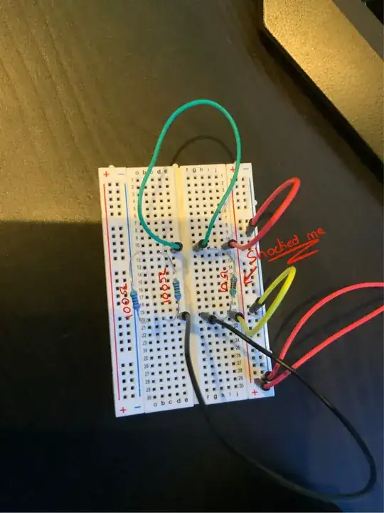

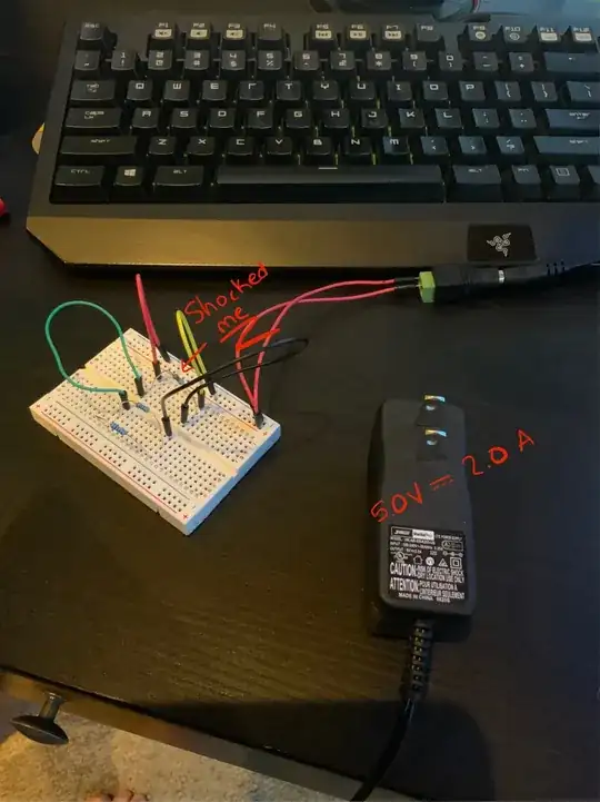

I was trying to visualize a beginner circuit problem on my breadboard and I plugged in my circuit, touched a resistor and got a nasty shock. I am a cs student playing with circuits to build some logic gates so I really am a complete beginner.
The power supply is 5V 2 Amps Why did this happen? How can I prevent this from happening in the future?

    @s_kirkiles It's the required "pri-to-sec" bridging capacitor, most likely. Class II product, I'll bet. You can easily test this. Put an analog (needle-like meter) voltmeter into AC mode and measure between your body and that shocking point. You'll probably read a substantial AC voltage and it will be fairly stable. Depending on the details of the supply, you may be able to reverse the plug and it will be lots better. – jonk May 08 '21 at 00:33
    First guess is static (ESD). Especially if the air is dry in the location where it occurred. – user57037 May 08 '21 at 00:43
    If it is a cheap two-prong power supply, it might have leakage current from mains-referenced common mode voltage. Most likely from a EMI filter capacitor between mains side and low voltage side. – Justme May 08 '21 at 08:37
  • If you really got an electric shock, the most likely reason is that your power supply is unsafe, or there is a fault in your house electrical wiring (e.g. a fault somewhere in the ground and neutral wiring or an incorrectly wired breaker). – alephzero May 08 '21 at 12:30
  • Most probably Y capacitor leakage. Can you ground the negative output to a sink, faucet, radiator or similar grounded part and see if you notice any difference. Preferably using a multimeter instead of yourself as the meter. – winny May 13 '21 at 20:35

OK. You say that it was a single jolt, and you pulled your hand away immediately.
It was one of two things -- either it was static discharge and a true shock, but exactly what you would have gotten from a doorknob, you burnt yourself, or it was an actual shock and I can't count.
You're running 5V through a \$10\Omega\$ resistor, which means that it's dissipating 2.5 Watts. That means it'll get hot in the thermal sense. That is, in fact, why it's a bit browned compared to the two 100 ohm resistors (which will dissipate 0.25 Watts at 5V). If you're expecting a shock, and you get burnt, you'll think you got a shock (trust me on this -- even if you've been doing it for 40 years, you'll still do it).
I'm pretty sure that's what you felt. It's hard to describe how to safely test a part that's sizzling hot for temperature -- it involves holding up the back of your finger to the part without touching it and feeling for heat, or briefly touching it and seeing if you feel heat afterwards. In extremis (I'm really bad about thermal safety) you lick your finger, touch briefly, and listen for a sizzle.
Had you hung onto the thing a bit longer, the "tss" sound, the bad-smelling smoke, and the shiny, resistor-sized spots on your thumb and forefinger would have let you know that it was thermal, not electrical.

    Straying from the original topic a little, but it should be noted that resistors have a power rating, and the pictured resistor is definitely not rated for 2.5 watts (probably it's 1/2 a watt or less). Using a sufficiently-rated resistor isn't going to guarantee it won't get hot, but it should guarantee that it won't get damaged. – IceGlasses May 10 '21 at 06:02

It could be that there is a short between the primary and secondary circuit of your power supply causing the high voltage from your wall outlet to be present on the outputs. Since the power supply is doubly isolated (as indicated by the symbol: square in a square), it is very unlikely that there could be a short between the primary and secondary windings, without the whole primary circuit/winding being shorted as well, causing your circuit breakers to go off when you plug the thing in.
If it wasn't just a static discharge, than the most likely culprit are your switched mode power supplies in your PC, that can generate a voltage (compared to earth ground) on the metallic parts of the PC and all other things connected to these metallic parts. This occurs, if the PC is plugged into a wall outlet, that is not grounded. In this case, if you touch something in contact with the metallic parts of your PC AND also something metallic in the building structure (pipes, radiator, aluminum window frame), then the current will flow through you down to earth ground, as these things are grounded.
The first certainly, but I think the second as well should be caught by your RCCB, if you have one installed. So in conclusion, probably it was just a static discharge. If you have a multimeter, you can just measure the AC voltage between the power supply outputs and whatever metallic structure you were touching at the time.

    I found with some cheap USB power supplies they had some leakage which is enough to feel without tripping anything, which is why I stopped buying them from ebay and switched to farnell. Also the symbol means 'doubly insulated' not isolated, though I'm not sure how you'd meet the requirement to not expose dangerous voltages without some isolation (the AC on the cheap ones was around 40V with no load so not 'dangerous', just tingly, seemed to be capacitive). – Pete Kirkham May 09 '21 at 09:40
  • @PeteKirkham One other way to make an know charger dangerous is using an USB ionizer product. these devices work by generating an high negative voltage, and then using carbon brushes to leak electrons into the air. These then find their way back to ground. The problem then is that there is no way back to the device, so the capacitor inside those chargers charges up beyond its safe levels and fails open, and which the transformer is the most likely to go, and develops a short between the primary and secondary – Ferrybig May 10 '21 at 11:10
You are using a switching power supply with a two prong mains connector. These often include a pair of (hopefully!!) Y1 rated capacitors bridging both poles of the mains connector to the output ground, for EMI suppression purposes. This lifts the output to half the mains voltage, if there are no further grounding provisions on the secondary (output) side. While the current should be limited enough to prevent any injury, especially with a 240V mains it can still sometimes be clearly felt when touching the output of such a power supply. And in some cases, it can damage circuitry that is connected to earth ground in some other place than circuit ground.
Connecting the ground (usually minus) pin of the output to actual earth/protective ground should eliminate this problem.
Consider getting a real lab power supply sometime - chargers, laptop power supplies, computer power supplies .... tend to make a bad substitute for them due to a) issues like this, b) usually non existent adjustable output current limiting (bad with AT/ATX computer power supplies, these can deliver car battery grade currents with very destructive results), c) dubious/not well defined short circuit handling (2.0A might NOT mean the current is limited to 2.0A, and short circuit proof might NOT mean overload proof!), d) sometimes actual safety problems with the cheapest models (eg internal insulation not up to code, or ordinary capacitors used where class Y1 would be required....) - such problems can be very bad if you use them for breadboarding where you expect to routinely touch bare, powered wiring).
