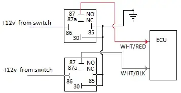

I have two relays to convert +12 volt circuits to "ground" inputs into a fuel injection ECU. If I connect the relay coil ground to the same ground as the "source" will I need to install a diode to prevent possible fly-back to the ECU?
Here is the diagram:

    Are you sure they're high-side (12v) switched outputs? It's more common to ground the relay coil to switch it, saves having to generate 12v in the ECU logic side. – John U Feb 18 '14 at 15:34

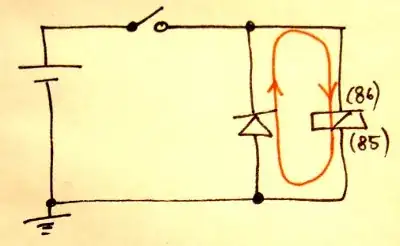

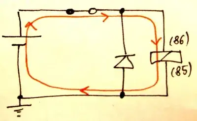

You need the flyback diodes because at the instant you open the switch, a relay's inductance will try to maintain the current. Adding a diode will create an easy path for this current to circulate until the relay's inductance has lost all its energy.
Charging the inductance from the battery and via the switch: charging the relay's inductance
Discharging the inductance via the diode: discharging the relay's inductance
Note how the direction of the current in the relay itself does not change and satisfies the rule that an inductance does not allow a rapid discontinuity of its current.

  • Thank you for your help and clear explanation of the circuit. I was fairly sure I was going to need to install a diode to help protect the ECU. Here is a link to the "rest" of the diagram I came up with for this application. It includes an 8-relay circuit board which already has diodes installed. – BPT Racing Jan 28 '13 at 18:54
  • (http://i382.photobucket.com/albums/oo264/bptracing/cudawirescolor3_zps19becd93.png) – BPT Racing Jan 28 '13 at 19:11
