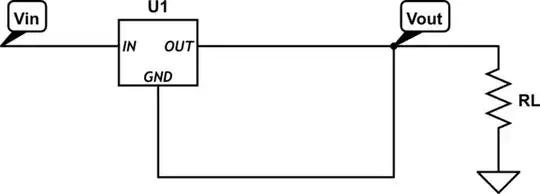

This circuit is supposed to be a current limiter but I don't understand why:
schematic
There is positive feedback between the output and the input, so you would expect the current and the voltage to start being increased until it is saturated.

    Show the original circuit idea and not how you have interpreted it. Include part names. – Andy aka May 02 '21 at 15:30
    No, that is not a current limiter. Please double check your drawing, and provide a part number for U1, because there are various ways and various types of regulators that could be used for current limiting. – Justme May 02 '21 at 15:30
    What chip is U1? Are you sure you're not missing a resistor at the OUT pin? – The Photon May 02 '21 at 15:30
  • Why do I have to include a part name? Don't all voltage regulators work the same? – Jun Seo-He May 02 '21 at 15:35
    Don't all voltage regulators work the same? They don't all respond in the same way, especially when you connect their OUT to GND. In electronics you cannot and must never assume a certain behavior, there are always exceptions, so include a part number (if you want your question to be taken seriously that is). – Bimpelrekkie May 02 '21 at 15:43
  • The schematic you drew doesn't even specify that the part is a voltage regulator, so even if they did all work the same, you wouldn't have provided enough information. – The Photon May 02 '21 at 16:40
"Don't all voltage regulators work the same?"
No. But many of the three-terminal devices such as 78xx and LM317 type are similar. The circuit you have posted will not work as a current limiter but you may be thinking of this circuit:

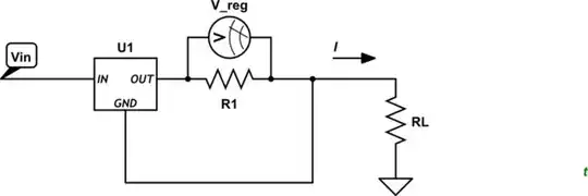

schematic
Figure 1. Conversion of a voltage regulator to a current limiter is possible with the addition of R1.
  • The regulator, U1, will adjust its VOUT to maintain the regulated rated output voltage (e.g. 5 V for a 7805) between OUT and GND.
  • For a given current set \$ R_1 = \frac {V_{REG}} I \$.

  • Just to note that this is a circuit of a current source and not of a current limiter. There is a significant difference between them although they are guite similar. – Circuit fantasist May 02 '21 at 21:28

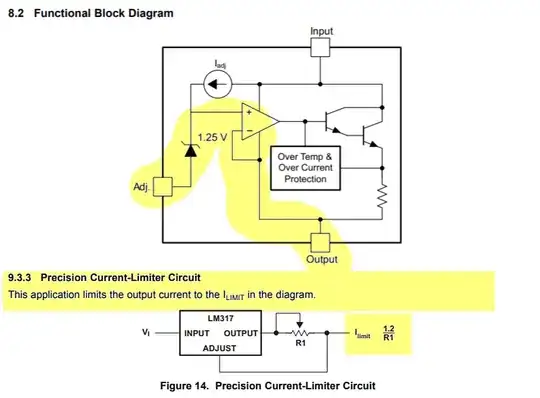

This is how an adjustable LDO with a constant 1.2V difference between Vout and Vadj is used to limit current to I.max = 1.2V/R with sufficient input voltage headroom and thermal calculations as well.
This is taken directly from the datasheet.
(Actually 1.25 V reference but differential amp may have some 50mV offset.)

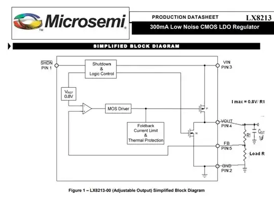

enter image description here This CMOS LDO has much lower dropout, lower Vref = 0.8V and lower current rating (300 mA max) but in a small SOT-23 package.
So this is useful for choosing a simple linear current limiter.
More complex types might use a 50mV current shunt a Vref, comparator and high current FET Pch series pass.
