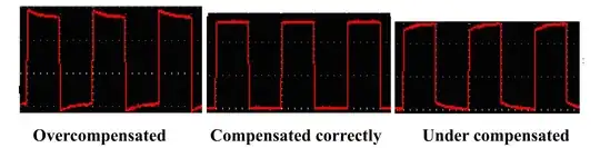

Basically the oscilloscope input front-end has its own internal capacitance and its own internal resistance. In order to prevent signal distortion, the capacitance of the probe needs to match the capacitance of the scope. If it isn't well matched, you'll get overshooting or undershooting. Most scopes have on their front a probe compensation connector which provides test signal that can be used to tune the capacitance of the probe. Here's image of the effect:
probe compensation

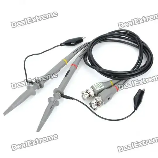

What is too expensive?
I've had excellent experiences with the ultra-cheap $12 dealextreme oscilloscope probes: enter image description here
They seem to be nearly identical to the probes that come with Owon Digital scopes, and for $12, they're practically disposable. I initially bought a pair out of curiosity, and they were nice enough that I have bought two additional pairs. The coax is very nice and soft and flexible, and they are good up to at least 10 Mhz (I don't have a faster signal generator at the moment), from my testing.
Dealextreme also has a lot of other scope probes, of varying speed rating, etc...
