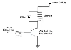

Use either of the circuits below taken from this answer; just take the output from your shift register as an input to the MOSFET gate or BJT base to greatly increase the available solenoid current.
Example from that answer using a BJT. The schematic calls out a Darlington transistor (effectively a two stage transistor); given that the solenoid requires 300mA that's probably wise unless you select a "super beta" transistor.

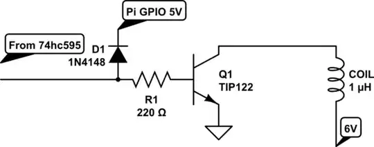

I would use a TIP122 transistor, with an 220 Ω - 1 kΩ basis resistor with a general-purpose diode (1N4148 or 1N4001) reversed biased for protection. As any overvoltage from the TIP122 would get shunted away from the Raspberry Pi's logic circuit.
the tip122 saturates 100% because it is designed specifically for this application. So almost all the applied voltage is across the coil. The 100V rating is the maximun voltage you can apply to the transistor. That is why they are commonly used as 12V-70V solenoid drivers. There are other ones like that, but this is the common one used. I've seen many pinball machines using the 74hc595 feeding a tip122 to drive their coils.

    The coil is the main culprit, not the transistor. Shouldn't the transistor be protected as well? The absolute maximum for the emitter-collector voltage is 100 V. Is it guaranteed to stay below that voltage (when switching)? – Peter Mortensen Apr 12 '21 at 17:16
    The switch time is on the order of 200 ns. What is the approximate maximum voltage over the relay coil? – Peter Mortensen Apr 12 '21 at 17:31
  • Tip122 has an internal dampening diode. That is why they were used in pinball machines to drive their coils with voltages up to 40V, and some of those pinball machines used 74hc595 to drive them too. – David Mikeska Apr 12 '21 at 18:37
  • Oh btw, the tip122 saturates 100% because it is designed specifically for this application. So almost all the applied voltage is across the coil. The 100V rating is the maximun voltage you can apply to the transistor. That is why they are commonly used as 12V-70V solenoid drivers. There are other ones like that, but this is the common one used. – David Mikeska Apr 12 '21 at 18:49
  • @DavidMikeska would something like this work? https://www.amazon.co.uk/Youmile-Darlington-Bipolar-Transistor-Resistors/dp/B08219LWK3/ref=sr_1_18?dchild=1&keywords=transistor&qid=1618259708&sr=8-18 – conor_b Apr 12 '21 at 20:53
    almost @conor_b You would have to get new resistors. 2.2K would be too much resistance. I usually just buy my stuff at Mouser, but that is interesting that people are selling grouped parts. 1K should work well enough. – David Mikeska Apr 13 '21 at 01:10
