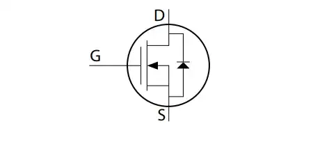

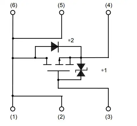

No it isn't. Just the symbol is (usually) enough to distinguish it.
Enhancement mode (from the datasheet):
Depletion mode (from an Ixys dataheet):
(you will note that the gaps are missing on the depletion mode symbol).
Too bad, there are many N-channel depletion mode MOSFETs but no P-channel that I know of. Depletion mode MOSFETs can come in very handy in some situations.
