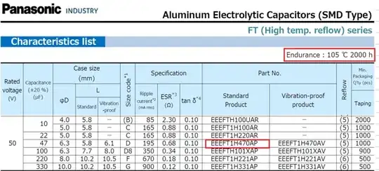

Can anyone some sample calculation on how to calculate the lifetime on an Aluminum Electrolytic capacitor who's Endurance value (Assumed as Lifetime value is 2000 hours at 105degC).

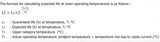

The manufacturer also gives a formula like below,

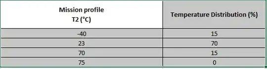

My working :
The below table is how much I am going to operate the capacitor at each temperature. And I am planning to use the capacitor for a lifetime of 10years which approximately comes to 87660 hours (considering leap year).
Can someone tell me the logic behind the below calculation.
Why is the last column values multiplied with 2000 (2000 h cap lifetime value)?
