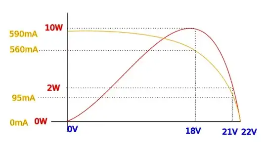

A PV Panel is not a battery, it resembles more a current source, but not really a constant one..
Here is a quick and dirty diagram of what your panel would be like. Note that it is not to scale but to bring a point across.
In Red, the power output vs Voltage In Orange/yellow the current vs voltage
Assuming that your regulator is operating at 80% efficiency, then for 2W output, this means that it is consuming 2.5W at its input.
  • There are two operational points of the solar panel for 2.5W delivery, more or less around the Vpv = 5V and around Vpv = 20V.
    • since you normally start at open circuit voltage and then the regulator starts pulling current you will be at around those Vpv = 20V and at 2.5W you will be consuming 125mA.
So far everything is as expected. As you say, the regulator is not hot, Panel voltage at 20V.. seems fine. you should check the current coming from the PV Panel it will probably be at 125mA or so, not 560mA or anywhere near the MPP since your load is not requesting to go there.
Just because a PV Panel has a maximum power available does not mean that you will operate at that point.

  • This all true but what is Vpv at max power? what should it be? Vmpt and what are the variables that affect this? – Tony Stewart EE75 Mar 27 '21 at 11:29
  • @TonyStewartSunnyskyguyEE75 : max power available @ STC (standard test Conditions) i.e. 1000W/m2 25ºC Cell temp, from the panel is given by the panel, its called Vmp = 18V, the max current at that point is called Imp = 0.56A , Max Power available , Pmp = Vmp*Imp = 10,08 Watts – Pau Coma Ramirez Mar 27 '21 at 11:44
  • The variables that affect this are mainly, cell temperature and incident irradiance on the panel, I did not get into details as for initial diagnosis of what appear to be happening it is not really needed, as long as the panel has more power available than required by the load – Pau Coma Ramirez Mar 27 '21 at 11:46
  • The answer is matched impedance at Vmpt – Tony Stewart EE75 Mar 27 '21 at 11:57
  • @TonyStewartSunnyskyguyEE75 you do not necessarily need to operate at Vmp, you can work at any point of the power curve of a pv panel. Its fine to work at a point which is different than the maximum power point. Normally you attempt to work at Vmp because you want to get the most juice you can from the panel given you have a in comparison "infinite" sink, i.e. an empty battery or the grid. – Pau Coma Ramirez Mar 27 '21 at 12:03
  • Of course and you won't get nearly the maximum efficiency unless between 72 & 82% Voc – Tony Stewart EE75 Mar 27 '21 at 13:49
  • With such a circuit, especially when you don't have control over the charging algorithm, you will very seldom be operating at the panels maximum power point. The problem is that the OP is claiming that he is getting 10W from the panel and only 2W out to the phone, thereby saying that the efficiency is so low. But they are probably not properly measuring the power output from the panel (input to the regulator) and the efficiency of the regulator is within spec and its just consuming what it needs from the panel. – Pau Coma Ramirez Mar 27 '21 at 14:10
  • the regulator was inefficient and the impedance matching is the correct answer to design any MPT converter. You don't need hunting algorithms but you can. Also no specs for DCR, ESR – Tony Stewart EE75 Mar 27 '21 at 14:15
  • Yes, impedance matching is the correct answer to operate at mpp given a load which will accept that available power, the problem is that the load that the user is connecting will most likely not operate at that point. – Pau Coma Ramirez Mar 27 '21 at 14:20
  • True it is up to the designer to make it at this Zo matching point – Tony Stewart EE75 Mar 27 '21 at 19:18
