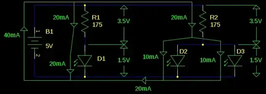

Here's a simplified example, with just two LEDs in parallel, compared to just one LED:
Here we assume that the voltage across an LED is always 1.5V. We know the battery is 5V, so the voltage across the resistors must be 3.5V. By Ohm's law, the current through R1 or R2 must be \$ 3.5V / 175\Omega = 20mA \$. On the left, this current has only one place to go, through D1. But on the right, this current is split in half.
Again, don't parallel LEDs like this. The problem is that between manufacturing variation and temperature dependence, we can't know if the LEDs will split the current 50%/50% or 10%/90%. If you size your resistor to supply enough current for five LEDs, and one ends up hogging all of it, it will probably get too hot and fail.

@KevinMacklin think of what happens when a river forks. Electricity is no different. See illustration. – Phil Frost Jan 21 '13 at 03:16

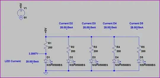

Okay, here is a demonstration with schematics:
One LED with a 200Ω resistor (current marked in blue - ~28mA):

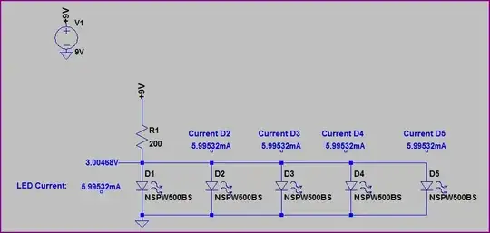

Now if we add the other 4 LEDs, but only use one resistor - note the current values have dropped (in the real world they would not be the same for each LED as mentioned above):
Now if we use a resistor for each LED, the current for each is the same as it was for the single LED:
Hopefully, you can see why we need a resistor for each LED.

Resistors in parallel add up to less resistance, it will work, yes - trust me ;-) For example, 2 x 100 ohm resistors in parallel would be 50 ohms (try it with a multimeter if you want to see for yourself) You need one on each because otherwise they will not share the current equally, and if too much current is available, will end up burning out. I will add a schematic - if they are white LEDs, then the Vf is higher (~3.5V), so they are probably set for about 20mA with the 200 ohms. – Oli Glaser Jan 21 '13 at 02:32
Okay, I added some schematics with the currents marked (ths is LTspice - a circuit simulator, which was used to calculate the currents) Looks like they are probably 30mA LEDs – Oli Glaser Jan 21 '13 at 02:56
