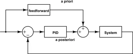

If the answer above is yes, then what purpose does a PID controller even have in this system?
In such case, if you already know what the output should be (we say knowing 'a priori'), you can feedforward it. The controller has a role of 'a posteriori' aka corrector. If there is a mismatch of the 'a priori' output setting, the controller will correct the discrepancy.
Even if I find a linear relation between input signal and output signal, doesn't this only hold true for a certain load (i.e. a certain surface friction and incline)?
That's why the controller is needed.
schematic
