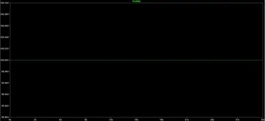

I'm a mathematics and physics student. I am trying to simulate the circuit from the paper "Design and implementation of a lightweight high-voltage power converter for electro-aerodynamic propulsion". However, this is my first time using LTspice and I'm struggling with it.
What I don't understand is why the signal in the voltage in the primary of the transformer isn't sinusoidal as expected but rather a DC signal of 100V. Consequently the signal isn't being multiplied by the transformer and the output voltage is 0.

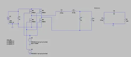

Picture of the circuit from LTspice: enter image description here
Node n004 is the node linked to the primary of the transformer:

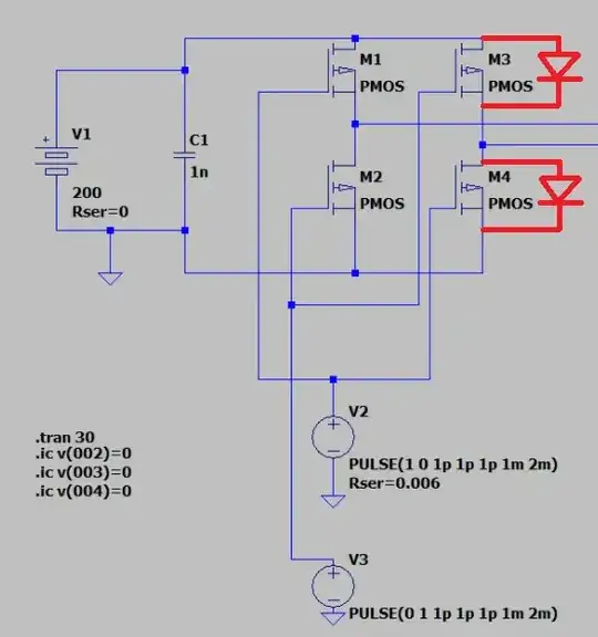

  • As several others have said - PMOS FETS here will conduct through their body diodes at all times. Magic smoke certan. PLUS gate drive is wrong - high side FETS are at +200V so Vgate must be 200V+ which low side FET "would not like" . – Russell McMahon Mar 23 '21 at 12:51
All your PMOS are upside down hence the parasitic diode in each (show by my red lines) is conducting a massive and unfeasible current from the power source: -
Given that the four PMOS are identical, the outputs will from a 2:1 potential divider and convert your input supply of 200 volts into an output of 100 volts.
I think you need to relook at what the original idea is behind your simulation because 4 MOSFETs wired like this can never properly work.

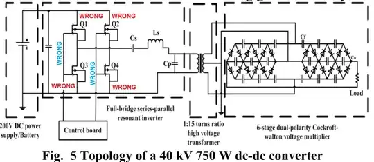

Original idea (oops they got that wrong):
Unfortunately, you can't rely on the diagram in the document you cite. It also shows PMOS devices (wrong) and also shows each half bridge gates connected together (also wrong): -
Here's a blow-up of Q1: -
Clearly and unambiguously, this is incorrectly drawn as a P channel MOSFET when it should be either an N channel MOSFET or a P channel device with source and drain reversed.

  • I have tried replacing the MOSFETs in another simulation with closed and open switches (when M1 and M4 are closed M2 and M3 are open), and the voltage output becomes 0. – Voltini Mar 21 '21 at 15:21
  • @Voltini then you are probably doing that 2nd circuit wrong also. I've explained where the main problem lies in the circuit you have shown in your question and that should be enough to fix it. Start simple with MOSFETs/switches - use one switch and a resistive load connected to the battery and get that working first. Don't jump in the deeper end first. They can be tricky to get right for newbies. – Andy aka Mar 21 '21 at 15:43
  • Is it possible to fix the circuit? – Voltini Mar 21 '21 at 16:21
  • It's possible to fix it in your simulation suite by using NMOS devices and using care in applying the proper gate-source voltage on each device (no connecting upper MOS gate to lower MOS gate because that will never ever work). Then, to get it to work in practice requires a few calculations and application of proper MOSFET driver circuits @Voltini – Andy aka Mar 21 '21 at 16:26

  • @TonyStewartSunnyskyguyEE75 1. WC -> CW ? | 2. The multiplier used does not seem pertinent to the OPs query. They do have the PFETs in the bridge with wrong polarity and gates connected bizarely BUT it appears that they intend it as a general indication of topology and not a correct circuit. (Not a good way to do things). – Russell McMahon Mar 23 '21 at 12:42
The ambiguity is in the symbols used to show an NCh FET. This one is special made from GaN.
The simplified schematic is in error. (draft-person error)
So your simulation must use the exact same parts and exact same layout to come even close to what the designer ended up with for every part!!
I don’t know the history of FET symbology but when it looks like a BJT with 1 plate for the gate and a horizontal arrow for the source going out to look like an NPN, it is not really a Pch FET as you and another answer writer believe, but rather it is a very special GaN NCh FET.
