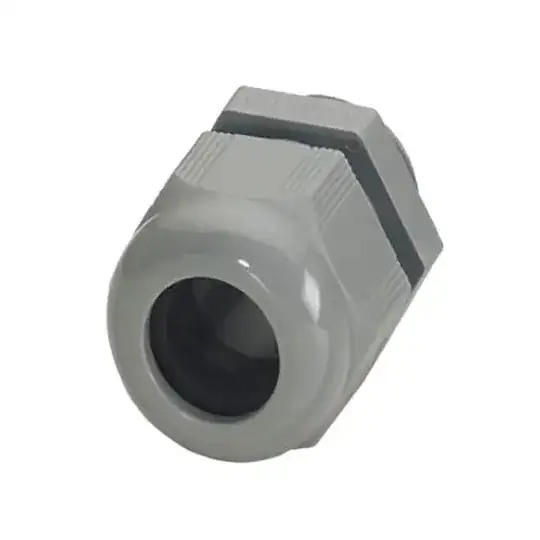

You can use a cable gland. For your use case:
- Select a cable gland which can hold a 6mm cable. These glands can either be made up of metal or nylon, like the "RS PRO PG 7 Cable Gland" or "HellermannTyton NGM M12 Cable Gland". At any rate, these should provide strain relief and at least IP67 rating -- you turn the gland with the cable passing through and the rubber or nylon material inside squeezes on the cable.
- You need to drill a hole larger than 6mm to accomodate the gland. The specific size depends on the gland that you'll be using.

Cable Grip or Cord Grip is another name for this type of part, by the way. – Nick Alexeev Mar 19 '21 at 22:28
You could just buy a grommet that fulfills your sealing requirements, and fits into a larger hole, and solve the strain relief issue on the outside, e.g. by a screw-on clamp thing.
However, standard way: Sealing Grommet/Strain relief to fasten into a hole:
https://www.digikey.com/en/products/detail/phoenix-contact/1411126/5188735
