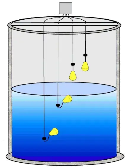

I've got a very simple, cheap, reliable solution for you: remote monitoring.
Nothing says your sensor has to be at the pump's inlet. You could place your sensor at the system's inlet. Submerge a cheap float sensor at the level of the inlet to the feeder pipe in your well (or whatever water source). Run wires back to the pump's power controller.
When the float sensor says the water level is below the feeder pipe, turn off the pump. Ten bucks, totally reliable. Done. =)
Multiple float switches are increasing depth in a tank
This figure shows multiple float switches at increasing depths in a tank to illustrate operation. You just need one at the bottom of your feed pipe. You do not need to disturb any existing plumbing to do this.

  • Excellent. I might have accepted this as an answer, but for one doubt. Is the only reason that pumps encounter dry-running, because there is no water at pump's inlet ? If I am confident that this is absolutely the only reason, I think I can accept this answer. Else, the flow-sensor seems to be more reliable. – bdutta74 Jan 19 '13 at 12:37
  • A definite vote-up for the excellent diagram. – bdutta74 Jan 19 '13 at 12:38
  • @icarus74 No, there are other reasons, including trapped air, pipe blockage, broken impellers, suction pipe leakage etc. The float method addresses one of the causes, whereas the current profiling mentioned in another answer, addresses the superset pattern of free-running of the pump motor. – Anindo Ghosh Jan 19 '13 at 17:50
  • @icarus74 -- If your system isn't leaking, then no water at system inlet = no water at pump inlet (or at least you've lost your fluid seal so the water in the inlet pipe will begin to fall back away from the pump due to gravity). You actually may not want to monitor at the pump inlet because you will need to run the pump briefly during dry conditions to prime it after the well refills (e.g. while the top of the inlet pipe is still dry and you are sucking up the new well water). – DrFriedParts Jan 19 '13 at 18:05
    I would also add that these systems are additive. The float sensor is the "best" approach in that it gives you the most performance/accuracy for the least cost, but you could certainly add current monitoring in addition. Knowing that there is water in the well helps make current profiling way more accurate. For example, you could detect blockages in this way. – DrFriedParts Jan 19 '13 at 18:08
