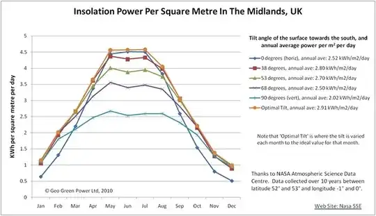

Here are some solar energy numbers from NASA for the Midlands in the UK (about the same for Wales I would imagine): -
We can see that a reasonable average daily energy per square metre is around 2.5 kWh for the UK. That's an average daily power of 104 watts per square metre.
Image taken from this site and 104 watts per square metre ties in nicely as an average.
If we factor in the solar panel's energy efficiency (maybe 20%), it becomes about 21 watts per square metre.
Given that the solar panel linked to in the question has dimensions of 185 mm x 250 mm, that's an area of 0.04625 square metres so, the viable average power that could be liberated is 0.963 watts.
Given also the efficiency of the converter is 80% then you can only really liberate about 0.77 watts
If you are wanting 12 volts, then the average current available will be about 64 mA.

  • This doesn't sound right. It says "UK hourly solar radiation data". So that would be the energy for an hour. 15 mW per square meter would be incredibly low. – Lars Hankeln Mar 18 '21 at 11:55
  • @LarsHankeln please explain that to the OP - I'm using his figures. – Andy aka Mar 18 '21 at 12:00
  • @Andy you appear to be confusing "average" with "total". As a sanity , 1288J is about 2 seconds worth of full sun, and even in Argyll we get more than that! It's a plausible figure for a daily average but I haven't read the linked report to find out. –  Mar 18 '21 at 12:03
  • You're right, I've clarified that the 470KJ/m2 was the average per hour. – Adam Leyshon Mar 18 '21 at 12:04
  • OK interesting, at 5V 0.77w would give ~150mA, that would be fine with me. Still higher than I expected, being optimistic of course. – Adam Leyshon Mar 18 '21 at 12:24
  • @BrianDrummond I was showing the OP that his interpretation of the the figures he found was flawed. – Andy aka Mar 18 '21 at 12:29
  • @Andyaka given that his figure was 135W/m^2 for Glamorgan and your newer figure is 104W/m^2 for the Midlands, they aren't so very far apart. –  Mar 18 '21 at 12:50
