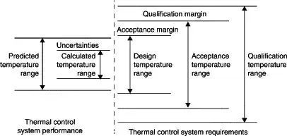

There's another couple of interesting things about temperature requirements that I don't think has been mentioned, particularly as it relates to MIL or NASA missions.
An example here helps. Let's use the -40C low temperature point that has been batted about. I will assume that this is the lowest temperature at which a part/assembly/system has to operate and meet all of it's performance requirements, when deployed (on Mars, in orbit, etc). This usually means that the assembly has to be tested at a lower temperature, -45C (acceptance test temperature), in order to provide some margin against the -40C requirement.
Then, in some circles there's this thing called "thermal uncertainty", which is basically a catch-all bucket for all the unknowns in your thermal model. A common value for thermal uncertainty is 11 deg C. At the low temperature end, this 11C is subtracted from your acceptance temperature (-45C in our example) to give us -56C. When selecting parts for this type of application, this is the low temperature point at which the part has to meet all of it's performance numbers, and so parts have to be selected guaranteed to operate at -56C, and not the -40C
