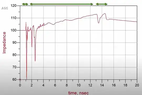

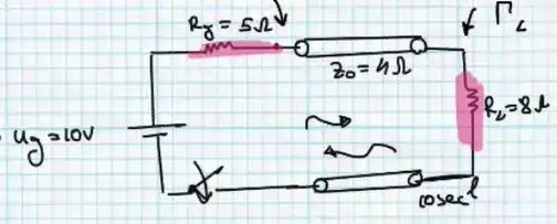

Based on the circuit below I have built the voltage based TDR diagram.

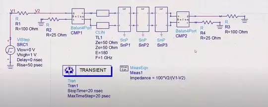

Then I went to the ADS TDR simulation and constructed by the manual the circuit below.
In the ADS circuit they say that IMPEDANCE=V/I=V/(delta(V)/R)=V*R/Voltage_drop_over_R
I can't see the logic of this formula.
Why does measuring impedance on the left side of the transmission line over time means its the impedance at some location in the transmission line?

  • None of the symbols in your formula appear in either schematic, so I don’t know what they refer to. However, if V is the voltage drop across a 2-terminal component A in any branch, R is a resistor in the same branch, and I is (voltage drop across R)/R, then it is certainly true that V/I is the impedance at A (the voltage across A divided by the current through A). This does not tell us the impedance anywhere else in the circuit. – 10ppb Mar 11 '21 at 13:50
  • Hello 10ppb,I have implemented an official keysight manual shown bellow. they say its impedance at every point(time varying location)
    https://www.youtube.com/watch?v=U3be5KkGmAc&t=121s
    – ron398 Mar 11 '21 at 14:31
