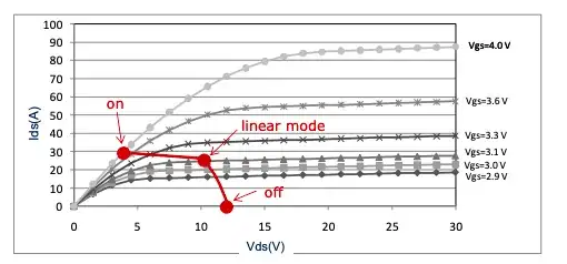

TI refers to it like this in an app note:
Snippet from a TI application note

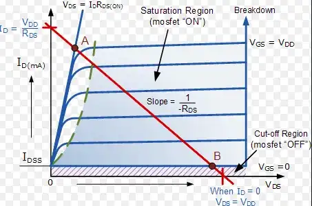

From this I implied that the 'linear' region is in fact rather confusingly the saturation region of the FET as shown all across the web for a FET curve:

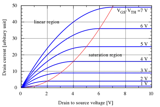

However, when I went to wikipedia I came across the following image:
This is saying the exact opposite of what I understood which is saying that the ohmic region is the linear region.
Infineon has an app note around FET switching, titled Linear Mode Operation
They refer to the linear mode as the saturation region as shown from this:

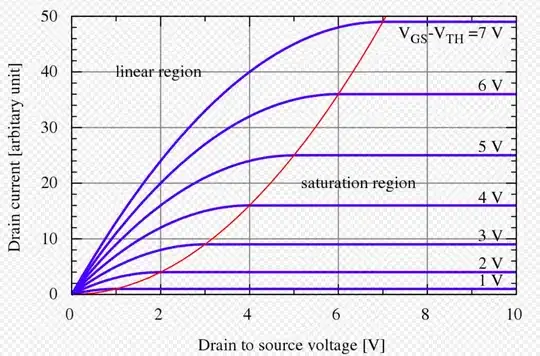

This is the correct graph: -
Taken from this wiki page.
Saturation refers to the channel being saturated and, as you said, no matter what \$V_{DS}\$ you apply, current remains constant. It is sometimes also referred to as the active region (not to be confused with the MOSFET being activated or ON).
The linear (triode) or ohmic region is when the MOSFET is used as a switch (ON). Your top graph (in the question) is basically wrong because it doesn't correctly show the different slopes in the ohmic region when you apply different gate voltages. This region is called linear because there are different slopes that are governed by the gate voltage and means the MOSFET can act like a variable resistor hence, it gets the name linear but, different texts use this term rather loosely.

  • The two links i have provided refer to saturation as the linear region. Also is TI in the snippet and link to the app note not referring to the linear region as the saturation region when they say 'it must go through it's linear region'. – Hasman404 Feb 27 '21 at 11:26
  • The so-called "linear" region does tend to be misused in some texts. And, I think that's because in a BJT, the saturation is sometimes referred to as the linear region. People forget that BJTs and MOSFETs (despite having similar looking characteristics) have a different saturation mechanism. – Andy aka Feb 27 '21 at 11:30
  • That is really annoying.. Infineon has a FET application note called linear operating mode (https://www.infineon.com/dgdl/Infineon-ApplicationNote_Linear_Mode_Operation_Safe_Operation_Diagram_MOSFETs-AN-v01_00-EN.pdf?fileId=db3a30433e30e4bf013e3646e9381200#:~:text=Many%20applications%20exist%20with%20the,to%20source%20(VGS)%20voltage.)
    They also refer to saturation as the linear region!
    – Hasman404 Feb 27 '21 at 11:36

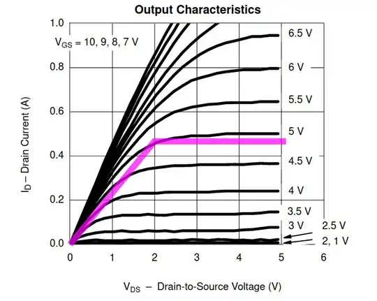

The following is a graph of output characteristics for an arbitrary 2N7000 MOSFET:-
graph
Assume a fixed gate drive \$ V_{GS} \$ of 5V and ignore all the other curves. So it's fixed. Consider the MOSFET then as an opaque component with only two legs, Drain and Source.
As \$V_{DS}\$ (voltage across component) changes, \$I_D\$ (current through component) changes. And they change almost linearly if you squint sideways at my graph (purple line). Like a resistor. The first part increases linearly, and then goes flat at saturation when it no longer behaves as a resistor. These are approximations, but form the basis of the terminology in your question. The difference is simply real world characteristics being more complex than theoretical approximations. And confusing graphs.
Actually the initial slope is \$ \propto V_{GS} - V_T \$ where \$V_T\$ is the threshold voltage.
