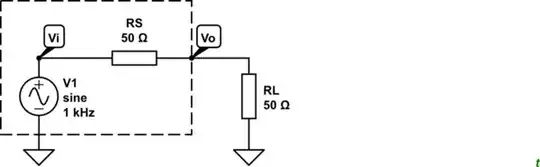

The voltage on a
schematic
Figure 1. Equivalent circuit.
The source and load resistor form a 2:1 voltage divider.
Measurement of VO without a load will result in a reading of twice the rated output. In other words, the output is only calibrated when running a 50 Ω load.
