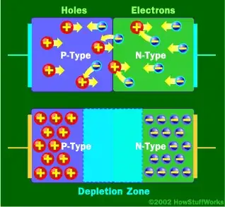

When you bring the P and N type materials together, you form a P-N junction. At the junction, some of the excess electrons cross over and fill the holes in the P-type material, forming a depletion zone (essentially a built in potential):
Depletion zone

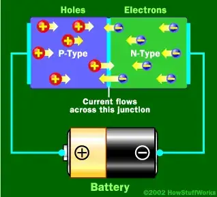

If it narrows, at a certain potential (~0.7V for a silicon diode) the diode will begin to conduct. This (hopefully) explains why the diode acts in the way it does.
Narrowing zone

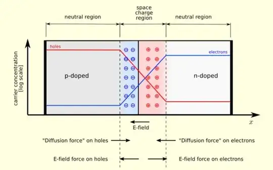

Also, this image (from the Wikipedia P-N Junction link above) shows the P-N junction with a little more information than the above images:
Wiki P-N Junction
