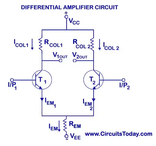

Can somebody explain what is this negative voltage -VEE in the circuit? I thought two parallel circuits are connected to the power supply vcc, but how this VEE came? Can somebody explain me this using simplified battery connection?

    Vee is a negative power supply. – Peter Bennett Feb 20 '21 at 16:59
    Vcc is the collector supply, Vee is the emitter supply. (These names are usually conventions for V+ and V- since NPN transistors are more popular) –  Feb 20 '21 at 17:01
    Sure try read this https://electronics.stackexchange.com/questions/370488/bjt-base-connected-to-ground-and-still-operates/370496#370496 – G36 Feb 20 '21 at 17:03
You only need VEE to be a negative voltage if you want the outputs to be able to swing around 0 V.
If you power the circuit from a single supply with VEE at 0 V then it should be fairly obvious that V1out and V2out cannot get down to 0 V as there will be a voltage drop across the transistor CE and REM. That means that your output voltages will be restricted to somewhere around mid-supply. This might be OK in some applications.
If, on the other hand, you make VEE a negative voltage with respect to circuit ground then your inputs and outputs can swing either side of zero. This may be a critical requirement in other applications.
