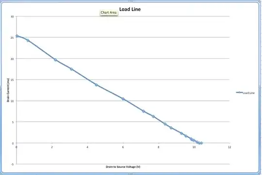

I am trying to learn the relationship between drain-gate (VDG) voltage and drain-source (VDS)voltage? From one of the QA readings in StackE, I understand that drain-gate voltage is less than drain-source voltage at MOSFET on condition. I am not sure how is it possible. At this on condition, drop across drain-source voltage would be so small. With that much of small drop, how (VDG) < (VDS) can be true? enter image description here Image is taken from here

  • @ElliotAlderson, I am taking about VGD itself. I am curious know how the value of VGD will change as MOSFET change its region of operation from linear to saturation. – student7 Feb 19 '21 at 01:36

    In the question you reference, they are asking what happens when you control a MOSFET with a gate voltage that is higher than the voltage the MOSFET is switching. For instance using a MOSFET with a 10V gate drive to control a 5V circuit. They are not referring to the voltage across the MOSFET when the mosfet is conducting. – K H Feb 19 '21 at 03:01
