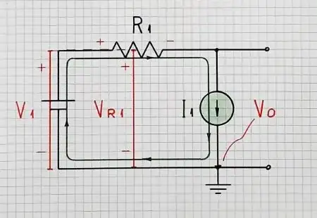

A real voltage source with a voltage V and internal resistance Ri is a typical example of your arrangement. Its output voltage Vout depends on the load current IL (Vout = V - IL.Ri). So, you can think of this connection as two voltage sources (V and IL.Ri) in series... although IL.Ri is a voltage drop (a part of V that is lost).
A more correct example is the case when a true current source acts as a load; see for example Why is the voltage drop created by a current source added. The voltage drop created by the current source can be subtracted from the main voltage - Fig. 1,
Opposing current source as a load
Fig. 1. Opposing current source as a load.

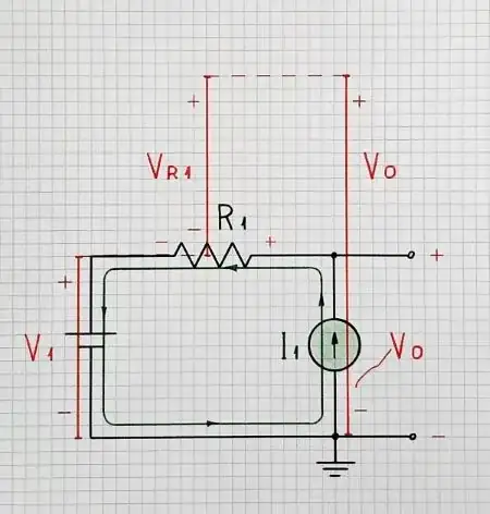

or can be added to the input voltage - Fig. 2.
Helping current source as a load
Fig. 2. Helping current source as a load.
The combination of the current source and resistor can be thought as another voltage source (Norton's arrangement) connected in series to the main voltage source.

  • The resistor whose current controls the voltage Vx is not necessarily in series with the voltage sources, and it certainly is not the "internal resistance" of either. Hence, the voltage across the two sources is not necessarily related to the current through them. – Elliot Alderson Feb 18 '21 at 22:04
