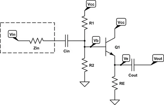

I'm self-studying electronics. I'm currently following "The Art of Electronics" (p. 84, 2.2.5 Emitter follower biasing), helping myself with additional videos and tutorials as I go.
I'm stuck trying to wrap my head around the output impedance of the following circuit: enter image description here
The input impedance looks really simple: It's just the resistance that the AC signal feels when getting into the circuit. I just have to follow the orange path in the following image to understand that it's going to be a parallel circuit made of \$R1\$, \$R2\$ and \$\beta\cdot Re\$ (because that's the impedance of a common emitter). I have come across many sources that agree with this result.
Continuing with that idea, I would imagine that the output impedance is the resistance between the output and \$Vcc\$, because that's what limits the current that can be feed into the output. I have drawn this path in blue.

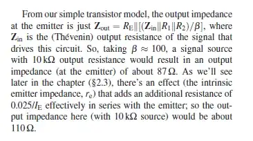

However, I see that in my book, it is stated that the output impedance would be \$Z_{out}=R_e||(\frac{Z_{in}||R_1||R_2)}{\beta})\$. I have not found sources on the internet that could clarify exactly how or why this result shows up. I have had trouble even finding articles about calculating $Z_{out}$ in this kind of circuit.
The question: What is the intuition behind this result and how can I get there on my own?
EDIT: fixed equation transcription error as noted in comments.

KCL Analysis, sans Intuition
Let's start by ignoring intuition for a moment and just working through the problem. To begin, the schematic:
schematic
(For those interested, I've provided the OP's fuller context at the end, below.)
Normally, for small signal purposes, you might also insert \$r_e\$ in the above circuit right at the tip of the emitter of \$Q_1\$. But the textbook is ignoring its value until section 2.3 and considering it absent for now.
You know that \$V_\text{B}-V_\text{E}=V_\text{BE}\$ and that for small signal purposes, absent \$r_e\$, this is a fixed voltage difference. This allows us to substitute one for the other. Also, note that \$I_\text{E}=\frac{V_\text{E}}{R_\text{E}}\$.
Assuming \$I_x\$ is an arbitrary current sink load that will be either \$0\:\text{A}\$ (no load) or \$1\:\text{A}\$ (loaded), then the KCL is:
$$\begin{align*} \frac{V_\text{E}+V_\text{BE}}{R_1}+\frac{V_\text{E}+V_\text{BE}}{R_2}+\frac{V_\text{E}+V_\text{BE}}{Z_\text{IN}}+\frac{\frac{V_\text{E}}{R_\text{E}}+I_x}{\beta+1}&=\frac{V_\text{CC}}{R_1}+\frac{0\:\text{V}}{R_2}+\frac{V_\text{IN}}{Z_\text{IN}}+\frac{\frac{0\:\text{V}}{R_\text{E}}}{\beta+1} \end{align*}$$
(In the above, I've placed the outflowing currents on the left side and the inflowing currents on the right side. Although I've written about this novel approach to KCL many times, a more recent example is shown here.)
So the above equation says
"The current flowing out of the base node through \$R_1\$, plus the current flowing out of the base node through \$R_2\$, plus the current flowing out of the base node through \$Z_\text{IN}\$, plus the current flowing out of the emitter node through \$R_\text{E}\$ as seen by the base node is equal to the current flowing into the base node from \$V_\text{CC}\$ through \$R_1\$, plus the current flowing into the base node from ground through \$R_2\$, plus the current flowing into the base node from \$V_\text{IN}\$ through \$Z_\text{IN}\$, plus the current flowing into the emitter node from ground through \$R_\text{E}\$ as seen by the base node."
If you solve the above for \$V_{\text{E}\left(I_x\right)}\$, then you can work out: \$Z_\text{OUT}=\frac{\Delta \,V_\text{E}}{\Delta\,I_\text{E}}=\frac{V_{\text{E}\left(I_x=0\right)}-V_{\text{E}\left(I_x=1\right)}}{1\:\text{A}-0\:\text{A}}\$:
$$Z_\text{OUT}= \frac{\frac1{\beta+1}\left(\beta+1\right)R_\text{E}\,R_1\, R_2\,Z_\text{IN}}{\left(\beta+1\right)R_\text{E}\,R_1\, R_2+\left(\beta+1\right)R_\text{E}\,R_1\,Z_\text{IN}+\left(\beta+1\right)R_\text{E}\, R_2\,Z_\text{IN}+R_1\, R_2\,Z_\text{IN}}$$
That's exactly the same result you'd get if you took \$\frac1{\beta+1}\left[R_1\mid\mid R_2\mid\mid Z_\text{IN}\mid\mid \left(\beta+1\right)R_\text{E} \right]\$ or, multiplying \$\frac1{\beta+1}\$ through:
$$Z_\text{OUT}=\left[\left(\frac{R_1\mid\mid R_2\mid\mid Z_\text{IN}}{\beta+1}\right)\mid\mid R_\text{E} \right]$$
The only difference here from the textbook being that the authors chose to use \$\beta\$ as an approximation for \$\beta+1\$.

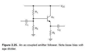

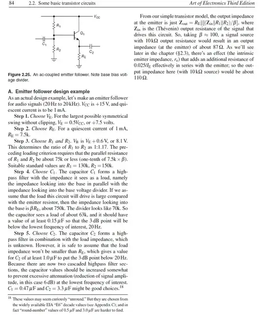

The Art of Electronics, 3rd edition, Page 84
The worked problem you cite has \$V_\text{CC}=+15\:\text{V}\$, \$R_1=130\:\text{k}\Omega\$, \$R_2=150\:\text{k}\Omega\$, \$Z_\text{IN}=10\:\text{k}\Omega\$, \$R_\text{E}=7.5\:\text{k}\Omega\$ and \$\beta=100\$. With those values, you should find that \$Z_\text{OUT}\approx 85.59\:\Omega\$ and \$A_v\approx 0.86446\$. The book writes that \$Z_\text{OUT}\approx 87\:\Omega\$, which is quite close enough.
As the book also points out, since the design is for \$I_\text{E}\approx 1\:\text{mA}\$, then the dynamic Ebers-Moll AC impedance value they will discuss later (\$r_e\$) will be about \$26\:\Omega\$. (They say \$r_e\approx 25\:\Omega\$.) This is added, in series and will increase \$Z_\text{OUT}\$ to \$Z_\text{OUT}\approx 112\:\Omega\$. (The book writes it as \$110\:\Omega\$ using their slightly smaller value.)
Getting overly precise is pointless, so the textbook is handling this just as you should: showing at most two digits of precision.
Fuller Context taken from The Art of Electronics, 3rd edition:
The OP failed to provide the worked example that was at question, I think:
They are relying upon a simpler BJT model that does NOT yet include \$g_m\$ and upon earlier discussions about \$Z_\text{IN}\$ and \$Z_\text{OUT}\$ that also help frame the above discussion in the textbook.

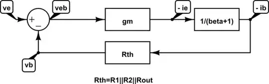

EDIT/Supplement
In the following, you will find another - very simple, intuitive and system-oriented - approach for finding the output resistance re for a common-collector stage.
For calculating the output resistance re, we connect a test voltage ve at the emitter node. The next step is to use only the basic formula ie=gm*vbe and to represent this relation as a small-signal block diagram using vbe=-veb=ve-vb:
schematic
(Note: I have used the commonly agreed sign convention for the currents: ib into the base and ie out of the emitter).
Case 1: When the base is grounded (example: source resistor Rout=0), we have no feedback loop (vb=0) and we find the ratio (as expected) re=Ve/(-ie)=1/gm .
Case 2: For a finite value of Rth the feedback loop ist closed (vb finite). From system theory we know that the input resistance is increased due to feedback by a factor (1-loop gain). From the diagram, we immediately can derive the loop gain expression:
Loop gain= - Rth[gm/(1+beta)]
Therefore: re=Ve/(-ie)=(1/gm)[1+Rth*gm/(1+beta)]=(1/gm)+Rth/(1+beta).
Of course - as the last step, the ohmic emitter resstor RE is to be considered in parallel to to re.

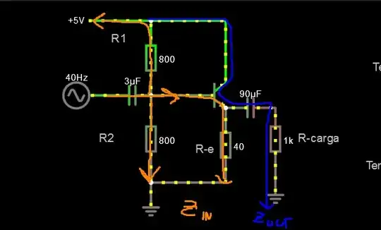

I know this thread is old and dead but you did want a simple intuitive answer to your inquiry…and so here it is. Imagine applying a source signal directly at the emitter. Initially the source would just see the base impedance (plus emitter resistance re) in parallel with RE…but then all of a sudden…the transistor wants to yank on the source current (because of the current gain) – it wants to draw way more current from the source than it had originally bargained for (reflecting a drop in impedance as seen by the source). Or at least that's how I see it.
