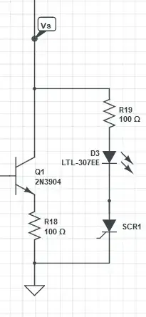

EDIT1: Attempt 1 Using SCR and Transistor:

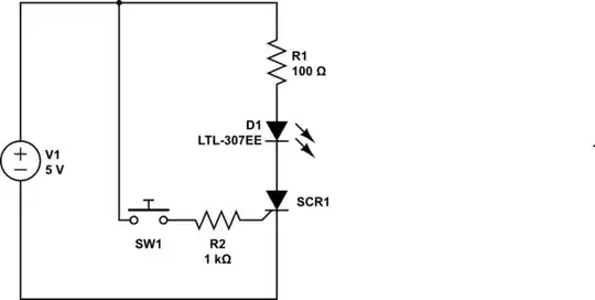

You don't need to complicate it with digital logic, just use an SCR.
When power is first applied no current flows through the LED.
After the button has been pressed, then the SCR is latched on and the LED is lit.
The only way to turn it off is to stop current from flowing through the SCR ie. remove power.
schematic

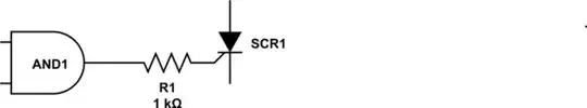

EDIT with AND gate control
schematic

  • The AND gate uses 2 comparator input, so if both the comparator inputs are high, then the LED turns on. So I think I would have to replace the switch with something. – EENoob Jan 28 '21 at 17:20
  • Should I use a transistor here? – EENoob Jan 28 '21 at 17:26
  • @EENoob see the update with an AND gate to control it. – Aaron Jan 28 '21 at 17:49
  • So if I understand correctly, if the voltage from AND1 is high, then SCR1 latches ON? – EENoob Jan 28 '21 at 18:32

  • @EENoob yes that is correct. – Aaron Jan 28 '21 at 19:48
