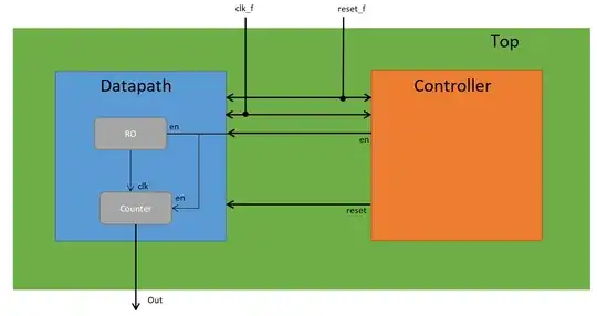

My design plan is as follow:
I have created three files , datapath, controller and a top module. In the Top module both of the datapath and controller are instantiated.
The datapath is the core Ring Oscillator PUF with a counter which counts its frequency.
The Controller is basically an Moore FSM. Which enables the RO for 0.5ms using a 100MHz Clock. So with a period of 10ns , it keeps incrementing a 16 bit counter and see if the it reached 50,000. If it is , it set enable = 0 meaning that 0.5ms has passed.

Datapath:
input: enable, reset,
output:  [31:0] counter
Controller: input : clk, output: reset, enable

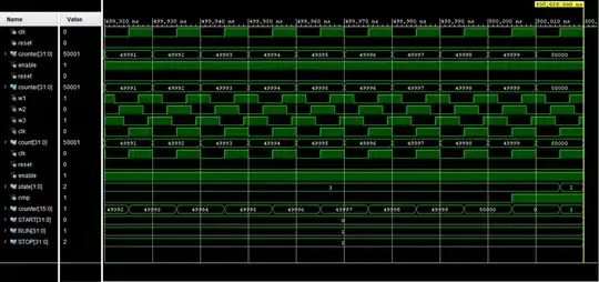

The results with the test bench  enter image description here
Running the simulation for 0.5ms The results seems correct and indicating the design works as expected.

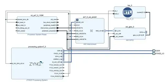

To see the results on the hardware. I have created IP block design having the top  (ON PL) connected to AXI GPIO with 32 bit channel.  Then then AXI connects to AXI Interconnect and finally ZYNQ processing system (PS).
The block design is as follow:
