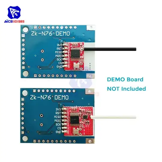

I bought those rf trans/receiver (GWB T400) enter image description here
I figured out that the sck, miso and mosi are for the spi communication. Gnd and 3v3 are pretty clear as well but I’m not sure what rst and cs are for. I don’t know where to look for to learn how to use it with my arduino either.

From the ali pages, the chip seems to be an LT8900 (Some ali vendors claim it has a NRF24L01, which I think is wrong. Check the marking on your modules.).
As you asked for info on how to use a SPI interface, I guess implementing a driver for this chip is way over your head. But this guy seems to have made and arduino driver for it, so you could try that.
Note that this is a 3.3V chip, so when you use a 5V arduino you will have to level-shift.
@nanofarad: I didn't check this chip, but radio chips often have both a CE pin that puts the chip in low-power mode, and a CS pin for the SPI interface. I think I recall a chip that, for greater confusion, swapped those pin names.
