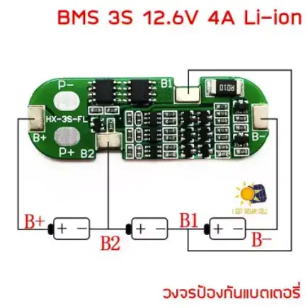

I like to use 2 x 3 16340 rechargeable lithium batteries because they are relative small. I think it is necessary to make sure the batteries are not discharged too low. This is why I think about using a BMS (battery management system). I plan to use two of these BMS:

For the balance charger I need to connect all individual batteries to the charger. And all the individual cells are connected to the BMS.
Now my question is: Is it ok when all cells are at the same time connected to the BMS and connected to the balance charger? Or do I have to disconnect the cells from the BMS when I charge them with the external balance charger?

About the BMS in the picture: I think about using that model because I could buy it easily and it's cheap. I looked at big electronic distributors and I didn't find any BMS in their shops.

    Hard to say from what you've posted but generally a charger expects to have ONLY the batteries connected to it and nothing else. And as many people have said in many answers, a BMS is not a charger. You must use a proper charger with these batteries. – Finbarr Jan 11 '21 at 11:38
  • Thanks @Andyaka That brings up the question: Where can I buy a quality BMS with datasheet? – Edgar Jan 11 '21 at 11:45
    Unfortunately this isn't a shopping recommendation site. For most pros, you would choose a chip and design it onto a circuit board. If you can find a module and it has a comprehensive data sheet and it looks like a quality part sourced through a reputable distributor then I might consider buying it but, if I can't determine that, I would look at designing a PCB. Would I take a risk with some cheap pee-bay or shamazon part - I might but, if it didn't work properly and I wanted to debug it, I'd be stuck and, so would anyone on SE if I raised a question about it. – Andy aka Jan 11 '21 at 11:47
