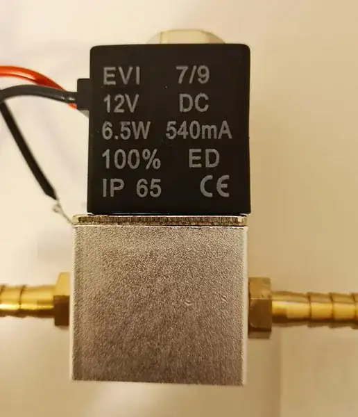

  • Solenoid is : 12v  540mA DC (normally closed)

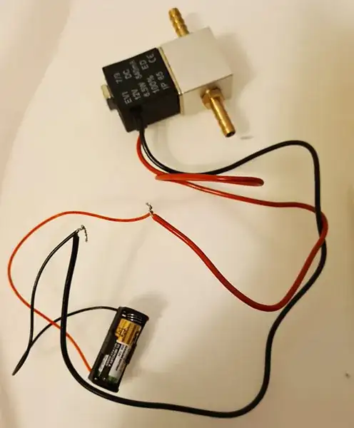

  1. Directly power solenoid with diode  (see image 1). I have also tried as explained here Can i use 12 v solenoid valve directly connect with the 12 v battery?. But mine did not work :(

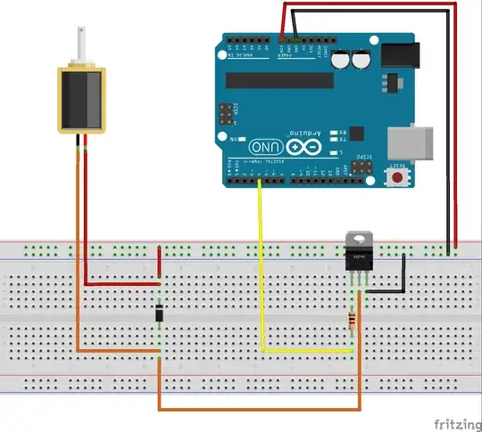

  2. Use arduino uno board to drive solenoid (see image2) - i have connected DC converter (12v 1A)  as power source plugged into Arduino board

  • The Fritzing cartoon doesn't show us the pinout of the transistor. (That's why we use schematics in which the symbols show the schema of the circuit.) Unplug the yellow wire from the microcontroller and connect it to the breadboard's red line. If the solenoid doesn't work the problem is on the breadboard. If it does the problem is on the microcontroller board. – Transistor Jan 07 '21 at 22:06

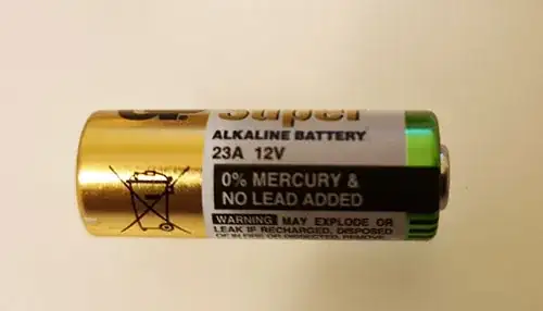

    23A batteries are very weak, not suitable for driving a 0.5 amp solenoid. "23A" is the type of battery, it has nothing to do with current capacity. – Mattman944 Jan 07 '21 at 22:11
  • Read the datasheet for that battery. (And weep). –  Jan 07 '21 at 22:22
Typical A23-type batteries are rated for about 15mA max load. Their short circuit current could be about 500mA. Estimating from that, the battery has an internal resistance of roughly 24 ohms.
The solenoid is rated for 6.5W at 12V, or 540mA. That is about 22 ohms.
Connecting those, you get roughly 6V over the solenoid with roughly 260mA of current.
That battery has no chance of operating the solenoid. It is meant for light pulsed loads such as remote controls, or even lighter constant loads.

  • @Venu. This. Try using your multimeter to measure the voltage across the solenoid when powered from your 23A battery (i.e between the two twisted wire connections in your photo). You should find it's nowhere near 12 V. – Graham Nye Jan 08 '21 at 00:39
